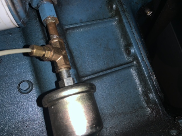

On the oil pressure gauge having too small of thread, usually they come with a pile of adapters in the package of every aftermarket oil pressure gauge that I have ever bought. If not any hardware store that sells "any" plumbing supplies should have an assortment of bushings/adapters, in galvanized, black iron and brass to choose from. You should be able to find an 1/8npt to 3/8 npt adapter there for a couple of bucks. Problem solved.

Mine’s a 1969. Went to Home Depot and found a tee that allowed me to connect gauge and sender. Here’s a pic:
(I just noticed... did my car came with a 3/8 to 1/8 already (prev owner?)? Things you find when looking twice...)

If all of that weight is hanging off the oil pump sender hole, you will likely break it off from stress/fatigue/vibration after some time. Ask me how I know...
