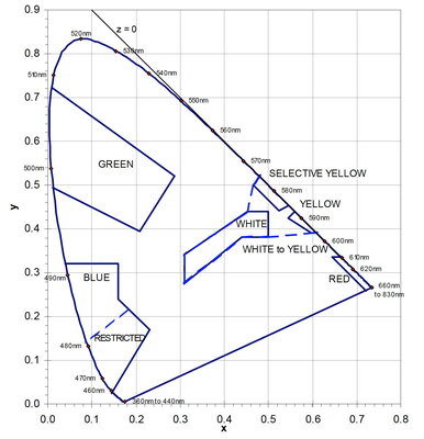

Another Dan question.
What wavelength(s) range of red led can be used for brake lights? Some people have more problems with longer wavelengths than others.....

What wavelength(s) range can be used for amber lights? (not too yellow and not too red)

Posts: 24933
In the relevant regs the colours aren't defined in terms of wavelength, but rather in terms of coordinates in the CIE 1931 colourspace. Amber is officially called "yellow", which is not the same as "selective yellow" ("yellow" is amber, and "selective yellow" is much less orange-y; it's primarily used in fog lamps as described here).
Red boundaries:
y = 0.335 (yellow boundary)
y = 0.980 – x (purple boundary)
With intersection points:
x = 0.645, y = 0.335
x = 0.665, y = 0.335
x = 0.735, y = 0.265
x = 0.721, y = 0.259
Yellow boundaries
y = 0.390 (red boundary)
y = 0.790 – 0.670x (white boundary)
y = x – 0.120 (green boundary)
x = 0.545, y = 0.425
x = 0.560, y = 0.440
x = 0.609, y = 0.390
x = 0.597, y = 0.390
There are some wavelength callouts in the attached CIE 1931 colourspace diagram, which has the various automotive colour boxes drawn in (including red and yellow according to the definitions above).
Are you asking because you have in mind to pick out some LEDs and try building some lamps from scratch? If so, that's a big and difficult job to do right; see here.
Or are you asking because you notice there's a large range of reds and ambers on the road and you're curious where the fence is? You're right, the yellow ranges from very orange to not-very-orange, and the red ranges from a deep cherry red to a red-orange to almost a red-pink. I don't know if some of these are markedly worse than others for people with red-green colourblindness. I would guess a red that contains no yellow could make safety problems that way, but a lot of automakers over the last 15 years or so have gone to the so-called "super red" LEDs for tail and/or brake lights (by comparison, the normal-red LEDs look almost orange), and I haven't heard a peep about colourblind people crashing into such cars. Here is an old blog post that approaches this topic.
