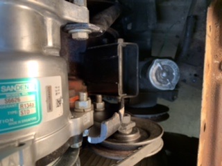

I have everything mounted but the pump pulley doesn’t align with the ps pulley on the front of the damper. I tried to load pictures but apparently this web site is too smart for me.

You are not telling me anything that I don’t already know. I have mounted the ac using the correct pulley attached to the back of the damper and I have attached the ps pulley to the front of the damper. Alt, wp and ac are installed and working properly. Don’t need help there. What I need is information on the correct PUMP pulley for an ac, ps engine. Do you have any information on that?

There are different PS pump pulley and pump mounting brackets for the AC / PS 225 SL6 vehicles.
The pulley is much "deeper" and the bracket that holds the pump, has a different mounting "off-set".

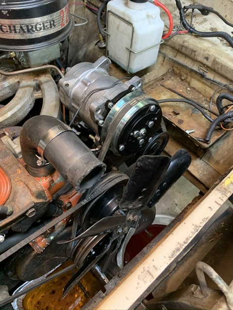

Then yep, the P/S pulley and pump bracket is different with vs. without A/C. The "with A/C" pulley is dished so as to move the belt groove forward, toward the radiator. The "without A/C" pulley is flatter. The brackets place the pump appropriately in accord with the pulley.
I modified the original Compressor bracket from a 1966 Plymouth Valiant slant 6 And mounted a Sanden compressor.
Cool! Can you show us pics?
As I mentioned I aligned it with the rear most pulley.
That is correct no matter with or without P/S.

File comment: Hope this loads ok. I don’t have a good pic of the bracket mods, but basically I cut the top off to make it wider in the opening at the top and then straightened it out to match the belt alignment.
