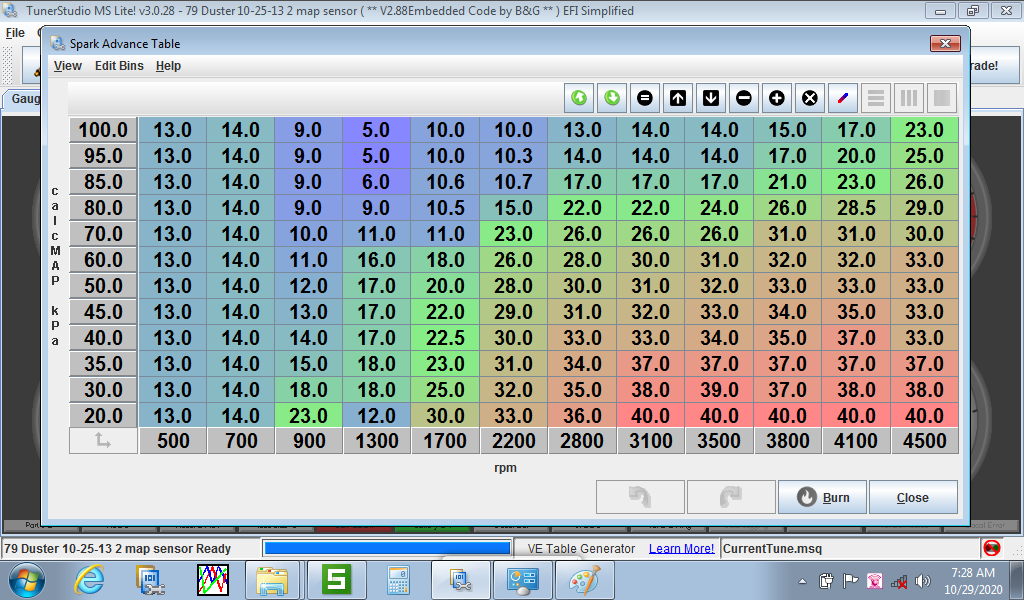

Bob and I are getting down to the wire putting our Lemons Turbo EFI build put together, and we have very little experience with EFI tuning. So I figured I'd ask, does anyone have a baseline fuel map we can steal to get started tuning this monster? We're using Microsquirt.

Author:  Greg Ondayko [ Wed Oct 28, 2020 11:59 am ]
Post subject:  Re: Baseline Fuel Map for Microsquirt?
Matt may chime in - I don't think there is a baseline for a slant as there are so many variables with an install.
if I can access my tuning laptop and get a file off it I can send my 79 Volare EFI file.. 34#/Hr Injectors - NA - -No Boost. and more compression / same valve size / same cam as you have.

Do you want a file or would pictures of the ve map and ign map suffice?
You also have to take into consideration the warmup enrich or disable it. And lastly the REQ_FUEL setting could be waaay off compared to your setup / injectors.

Author:  Greg Ondayko [ Thu Oct 29, 2020 8:13 am ]
I am not sure how helpful these will be as I believe the maps are for each specific build / type flow rating of the injectors ... if nothing else it will be a nice picture of numbers.

Author:  MadScientistMatt [ Mon Nov 02, 2020 5:02 am ]
The VE tables are designed to be independent of the injector size - the ideas is to have the injector data elsewhere, so if you swap injectors the only thing you have to tune is injector data itself.
I sent Frank a copy of my tune as well, but it is a very rough tune as the tuning got cut short when I lost a rod bearing.

Author:  Greg Ondayko [ Mon Nov 02, 2020 11:08 am ]
does that mean the REQ_FUEL number in the injector settings?
