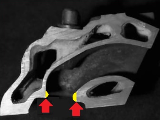

Head work per Doug's book ("Cleaning Up the Imperfections" and the intake port work shown in the photo)
