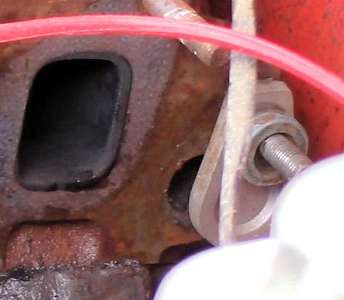

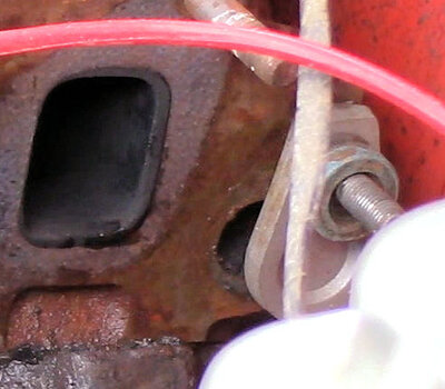

What is this? I pulled the manifolds because of smoke leaking around the gasket when I put a smoker on the engine. After I pulled the manifolds I found this tab and washer that are not connected to the manifolds.

Air injecton port.
Some models after 76 may or may not have it. If you don't have an air pump or other properly functioning emissions devices leave it plugged/ capped.

Thank you. I will put a nut back where it belongs before I install the manifolds. I built a drill fixture to hold the exhaust manifold on my drill press to drill out the two broken bolts between the manifolds. That helped me keep things in line and drill straight through. I was surprised to find that there is only one long bolt. I thought there were two bolts in the exhaust manifold to hold the manifolds to gether and attach the throttle cable bracket. it took a lot of heat to get the nuts loose from those bolts. The gasket was very thin, and there are a lot of rough surfaces on the exhaust manifold where it joins the head, which is why they never formed a good seal after the head was rebuilt 5 years ago. From a for sale add I found from 5 years ago, very few miles have been driven since. Can I use a grinder to level out some of the higher irregularities to help get a good seal with the head when I install the manifolds without creating more problems?

That air injection port cover needs its gasket (real, not squeezed out from a tube) or you'll have an exhaust leak.

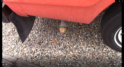

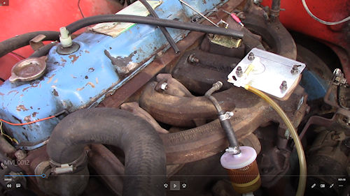

I have never removed the cover from the head, so what was there is what you see. I will make a gasket to cover the hole. I have fought all kinds of symptoms as you will see if you read my first posting. In the end I put in a breaker point distributor because I was getting weird things like only 3 cylinders firing, no low idle, and no consistancy. The smoker led me to the gaskets very quickly after I turned it on. I hope this the end of the problems. The engine itself is in very good condition.
