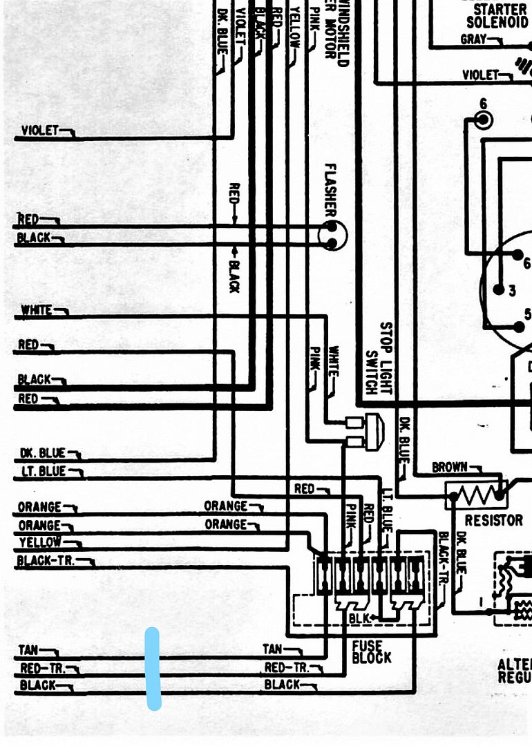

| Author: | matv91 [ Thu Jan 28, 2021 5:09 pm ] |
| Post subject: | Re: fuse block replacement |
http://www.mymopar.com/index.php?pid=26 wiring diagrams |
| Author: | matv91 [ Thu Jan 28, 2021 5:39 pm ] |
| Author: | matv91 [ Thu Jan 28, 2021 6:43 pm ] |
red-tr no circuit protection at all.
| Author: | matv91 [ Thu Jan 28, 2021 6:48 pm ] |
Put an inline fuse or circuit breaker where that blue arrow is 25 or 30 amps don't know, also another in line fuse or breaker at the alternator output wire. Make sure that wiring diagram matches the car. At the fuse block you can splice in an inline fuse to those connections, to replace your existing fuse. That's if your skill level is up to this kind of stuff. |
