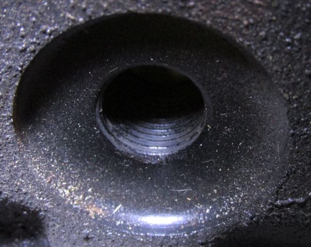

I would like to see a photo comparison of the Machined recess head (63-74) vs the early ones (60-62)

PostPosted: Fri May 28, 2021 6:45 pm
Posts: 2756
I don't have anything new in the garage now, but here is an old head spark plug photo.
Casting number 2206035.
