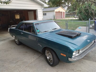

My name is Chuckster. My 14 year old grandson, Logan, recently bought a '72 Dart Swinger 2 door as a project him and I will work on so he can drive it when he turns 16. We live in central Illinois. We (grandson, my daughter, and I) drove just over 3 hours north to Marengo, IL. to look at it, bought it, and drove it home! We passed the Chrysler plant in Belvidere to get there. Only issue we had was a possibly factory spring clamp on the bypass hose rusted in two, causing an anti-freeze containment issue. Once we replaced the clamp (by bypassing the heater core to borrow a clamp) and adding water we made it home without any issues. It's a factory A/C car (but all under-hood items are missing), power steering, manual disc brakes, and someone recently converted it to Electronic Ignition. It does have some rust, but it was undercoated when new, so it doesn't appear to be too bad for a car that has lived in Illinois it's whole life!
We are currently working on the mechanicals to keep it in running condition. So far we have changed both motor mounts (pass side was in 3 pieces, had a little extra lean to it...lol), removed the radiator, thermostat, and water pump to replace with new. Tomorrow we will tackle replacing the timing chain and gears (doesn't look like its ever been apart), and going to try adjusting the power steering box to try and eliminate the large amount of play in the wheel.

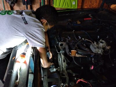

Grandson and I have been working on it every day when he gets home from school. Aside from the motor mounts we've replaced the transmission mount (a gorilla with a 25" breaker bar and a 6' cheater pipe must have tightened the cross-member bolts...lol), and the timing chain and cam gear. No matter what we used we could not get the factory crank gear to come off. We tried heat, various pullers, and a pry bar. So we left it on. Wasn't sure which of the timing marks to use on the front pully assembly as we previously removed the distributor to access a bolt for the motor mount. We pulled the spark plugs, hooked up the battery, and cranked the engine over with my finger in the #1 plug hole. As the compression started to blow past my finger I knew we were close to TDC. We put the timing chain cover on, then slipped on the pulley assembly, and rotated the engine to the next timing mark...TDC!!! According to my old Motors Manual the marks on both gears should be right next to each other, but the cam gear mark was off by 180 degrees. We put it together as it was, dropped in the battery, and she started right up! We figured if it was really 180 degrees off it wouldn't start, and I would pull the distributor and turn the rotor 180, then reinstall it.
We also adjusted the power steering box and got a lot of play out of it. Will have to take it around the block to make sure it will steer ok. Next we will be cleaning the engine and parts so we can put the front of the engine back together.
Chuck

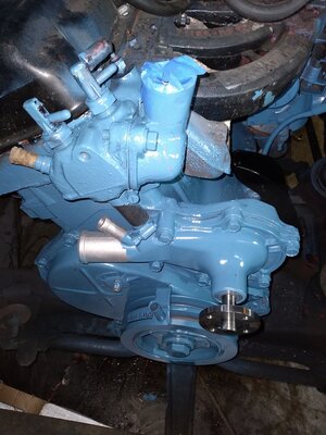

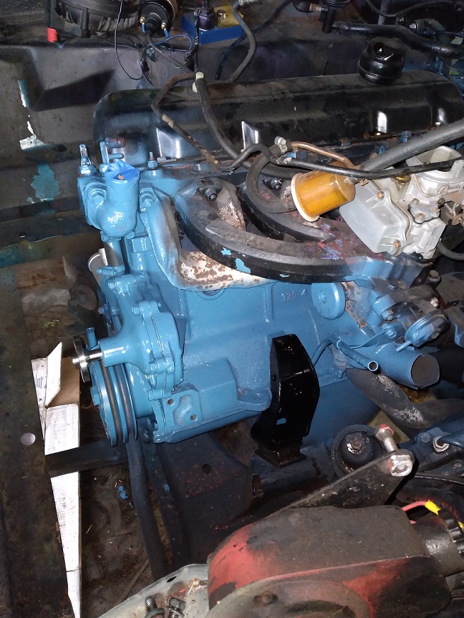

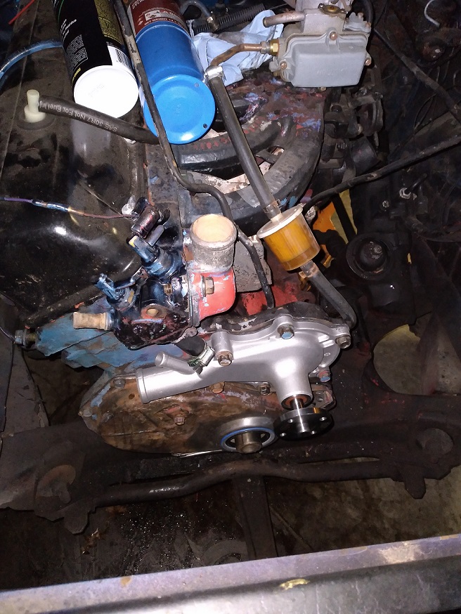

The last week, and today, we got all of the old, probably factory, gasket material from around the timing cover and water pump. That was a lot of work. Wound up using my right-angle drill with a cup brush, and it was slow going. Last Thursday we tried installing the timing cover, but couldn't get the two dowel pins through the holes in the cover. Only way I could figure out how to do it was by dropping the oil pan slightly. Friday my grandson got underneath and loosened the pan bolts about 2 turns. Had to raise the engine a little and remove the driver's side motor mount bracket to access a few of the bolts. Today we were able to drop the front of the pan just enough to seat the timing cover. Then we proceeded to install the new water pump and bypass hose (with worm-style clamps), and the new 180 degree thermostat. Hopefully tomorrow we can repaint the front of the engine Chrysler blue, along with some other areas we can get clean enough.

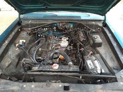

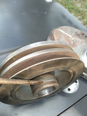

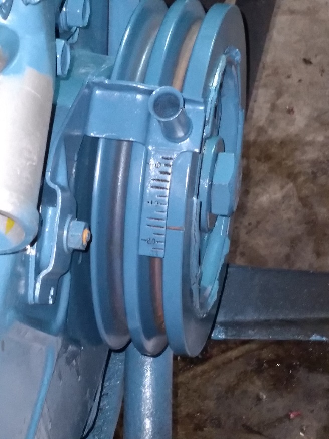

Made some good progress today, I cleaned and painted the left motor mount bracket while Logan was in school. When he got home we did a lot of cleaning and painting, installed the left motor mount bracket, installed a repair sleeve (groove in damper where seal rides) and installed the harmonic damper. A few days ago I detailed the timing mark bracket to easier see the marks.
Tomorrow the carb comes off to replace the leaky carb to intake gasket. Will probably do some cleaning of the intake while the carb is off, and paint it blue.
