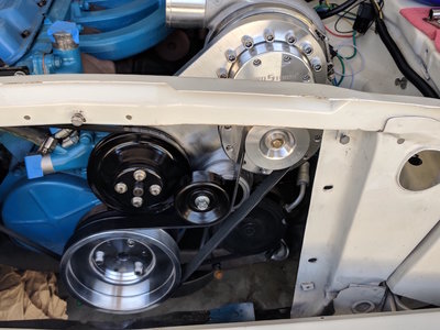

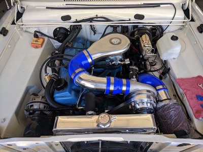

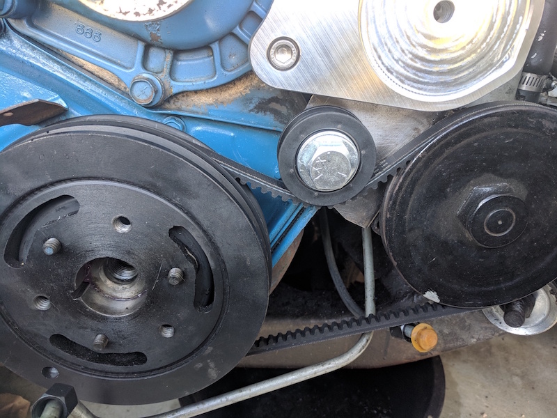

Its been about 2 months since I started installing the Supercharger kit from TorqStorm on my 64 Dart Convertible. I actually started prepping for it in Sept 17 by adding power front disc brakes. Gauges - Tach, Oil Pressure, Trans Temp, Vac/ Boost, and Wide Band O2. A 2.25" free flow exhaust. And a stock 74 electronic ignition. So the kit was great and had lots of instructions. I have also talked with Chris at TorqStorm and he has been very helpful. I have a few challenges because of decisions I made regarding staying with the single barrel manifold and keeping the power steering. I decided to use a Weber 32/36 DGEV progressive 2 barrel for the blow thru application. This required a small adapter and then I fabbed some brackets to use the stock linkage. Unfortunately it was too tall so I needed to replace the hat and tubing that came with the kit. The supercharger uses the PS pulley position, so I sourced the back pulley used by AC, which I don't have, and added an idler pulley to clear the supercharger bracket. The other issue with the power steering was that the box blocked where the kit wanted to put the intake. So I moved the battery to the trunk and am fashioning a CAI. I also put a nipple on the fuel pump atmospheric port to see if it will handle the boost reference and upgraded to a 3 row aluminum radiator. Everything fits with some pretty tight tolerances. I have it mostly installed and plan to fire it up in a few weeks. Wish me luck (hopefully good, haha).
Cheers, Bill.
File comment: PS re-route
File comment: Belt layout
File comment: Almost there

Well, Rodger the Dodger is back on the road and running great. I found this wonder material PA light project PVC and fabbed the CAI with a utility knife, heat gun, and PVC cement!
I am not registering as much boost as I expected, 3 lbs max, but suspect the plumbing. I ordered a doohickey to hook up the intake to my air compressor and will suss this out.
