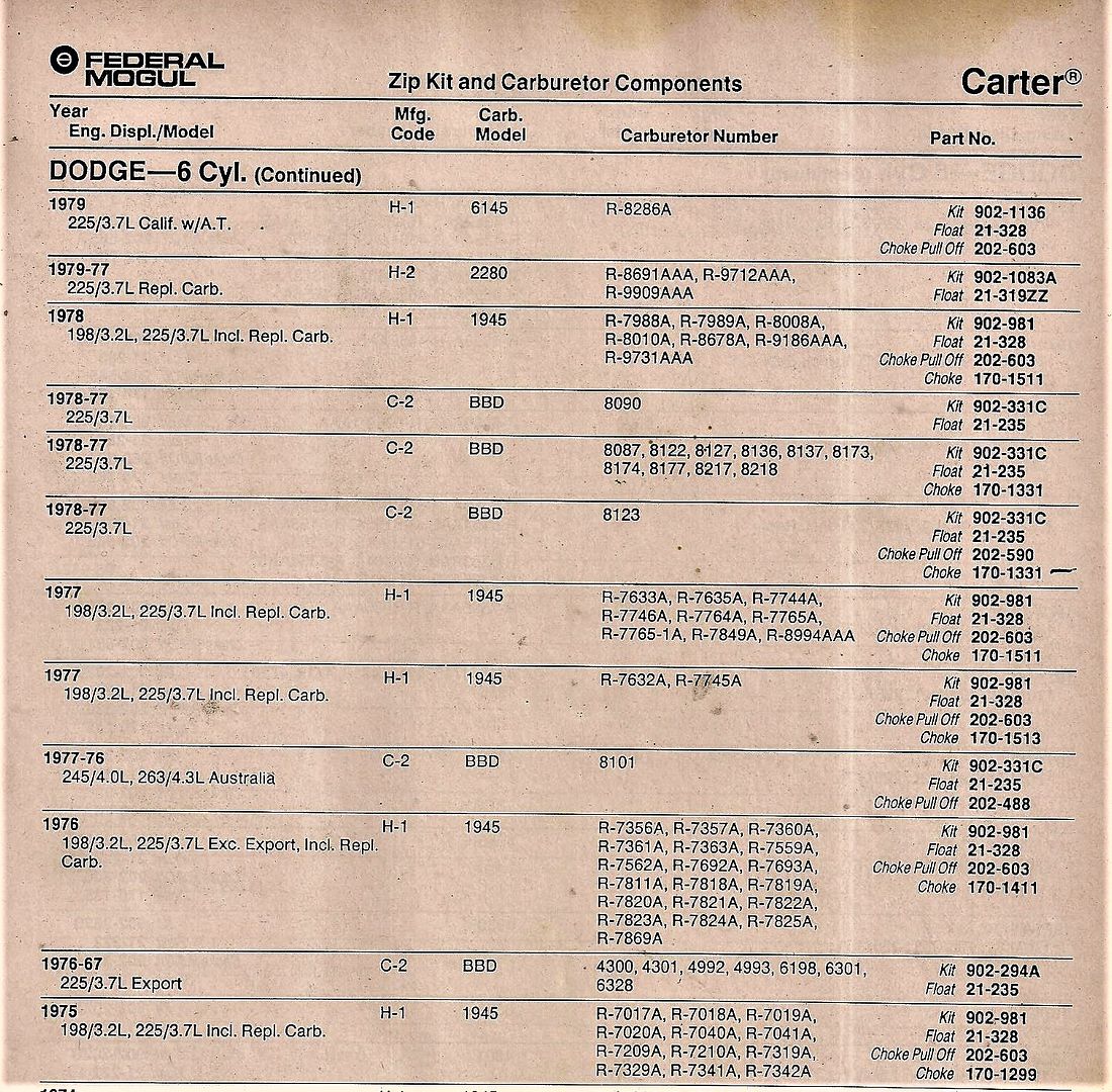

second from bottom is your tag number ,export bbd for slant six , no choke parts listed. So you have 2 idle mixture screws and one hot curb idle speed screw and no choke on fast idle speed screw? |

Info in that book matches your tag number and application years manual transmission |

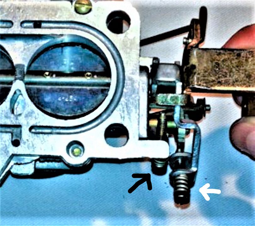

Black is hot curb idle, white is choke fast idle

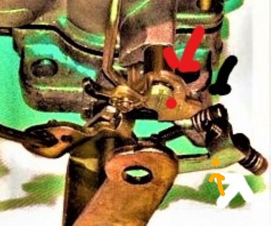

white fast idle black curb idle red fast idle cam is it there ?

yellow bracket for fast idle screw is it there?
