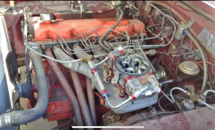

PostPosted: Tue Dec 07, 2021 11:00 am
Joined: Sun Nov 07, 2021 12:32 pm
Posts: 4
Location: Rochester wa 98579
Car Model: 1971 plymouth duster
I just scored this slant six with hyperpack guy said it did 10.8s!!
PostPosted: Tue Dec 07, 2021 11:36 am
Posts: 10448
blast from the past.
10.8 on gas in the 1/8 mile
or 10.8 on nitrous in the 1/4 mile?
