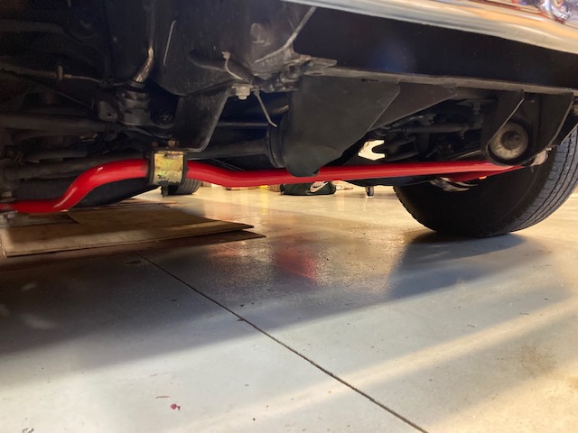

I have a front stabilizer bar on the D150, found it at a pull a part on a D 250 Camper special, years ago when I re built the 83 D150.
I found a bushing that fit through one of the after market urethane cab mount or after market sway bar suppliers. I remember having to split the bushing to get it around the bar. The two piece brackets fully encase the bushing and it had not been a problem. The threaded rod that is attached to the bracket was rusted real bad on the set I found. I drilled out what was left of the stud, and inserted a bolt of similar length and diameter to what it would have been new, welded it in place then ground the bolt head down some. It has held up fine for 10 + years

Too many years ago for a part number, but it should be a common ID and OD, I do remember splitting the bushing to get it on and remember to get the OD a bit oversize to allow for some compression.
Looking at the sway bar today for the photos, the center link bushings and collars are obviously some current aftermarket pieces.
I had the sway bar powder coated and it has held up well.
