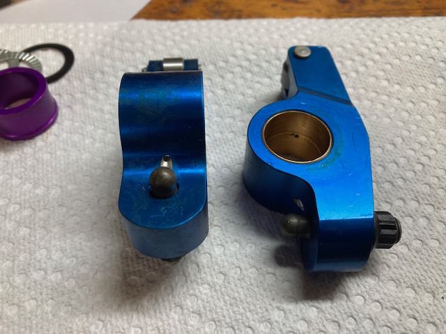

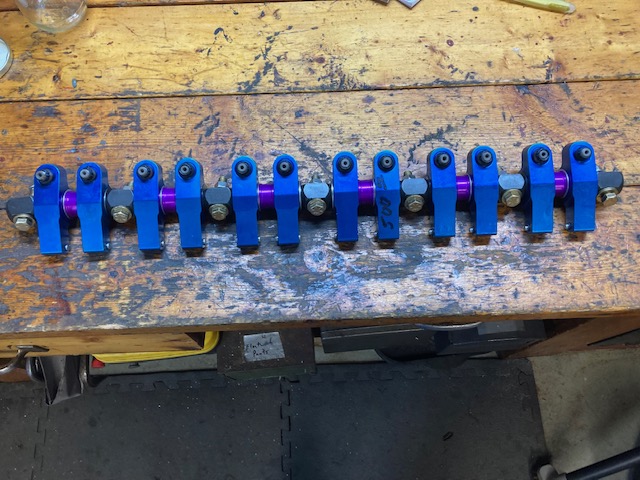

Several years ago I purchased a set of slant six roller rockers from Jim Cox.

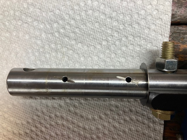

These are 1.5 ratio, appear to be well made, they have bushings at the shaft,
drilled oil passages to the roller tip and the adjuster ball. The shaft has banana cuts
at the oil exits. The reground camshaft in this engine was a hydraulic cam so it has full time oiling.
I have the oil flow restricted using a bushing on the rear bolt, but it is still getting plenty up top.
I understand there are no huge performance gains with roller rockers,
but I have a lot of trick stuff in this motor and I already have this set.
Asking if anyone in this slant six world has experience with roller rockers in use outside of a dedicated strip car?
It is doubtful that I will put 50,000 miles on the 68 Barracuda, but it will see some long distance travel as well as track time.
Thoughts and opinions?

 Post subject: Re: Roller Rockers
PostPosted: Sun Dec 05, 2021 5:56 pm
Posts: 9541
Tip oiling was the only problem I can remember. It sounds like yours has that covered?

Some of those shafts(from various Vendors) were more flexible than stock ones.. I had to be careful on the torque on mine, A bit less torque on the shaft mounting bolts with loctite..

Ditto with shaft wall thickness and flexing on the later RAS setups (which is what I think Jim sold). I tried an earlier set on the street and it noticeably wore the valve tips within a few 1000 miles. I have never run rollers since. I have a couple of sets still. I've been meaning to cut a groove in the rocker bushing to run oil betwixt the two oil holes (one to hit rocker shaft and one to hit oil hold to tip end). That seemed to be the problem with the tip oiling, from what I somewhat foggily recollect. I'd have to pull out a set and look. Would be nice to use one of these at some point.
Basically, I've been able to run 13s-14s in NA street cars w/stock rockers, and did not see a clear gain when I bolted on the rollers, so I have not bothered to try to make them work on the street. I do get some stock rocker accelerated wear over time with big cams and road racing, but I have a LOT of spares so that's free...
Greg made a spray bar for the inside of the valve cover for his hyperpak Dart, right? That seems to make 'em live on the street.

Oh, I did look at swapping in a stock Mopar shaft, but it is about the same wall thickness as the late RAS shaft. I think the issue is that the clearance between rockers and shaft was large on the stockers, and pretty tight on the rollers. Torquing or over torquing the shaft with stockers won't bind 'em, but distortion of the shaft with the rollers will. Anyway, things to check...

I had an early wet of RAS I tried on the street. They beat up the stems in less than 1000 miles. I think they started drilling them after that.
John, you need to build a valve cover with a clear top to show them off. They are pretty to look at. :mrgreen:

Roller tip rockers are over-rated in most cases. A properly set up pad rocker offers a lot of advantages.
That said, when I do use rollers I never, ever run them without lash caps. That protects the valve tip.
