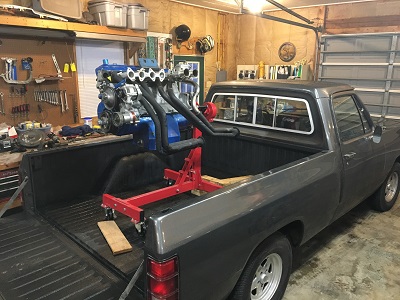

I have a picture on my build somewhere. The front half goes through the K frame so it is from the frame a good ways. 4" maybe..?
PostPosted: Thu May 12, 2022 3:27 am
Posts: 9525
The rear tubes were modified on mine but not at the bottom by the frame. Mods were up at the top around the intake.
