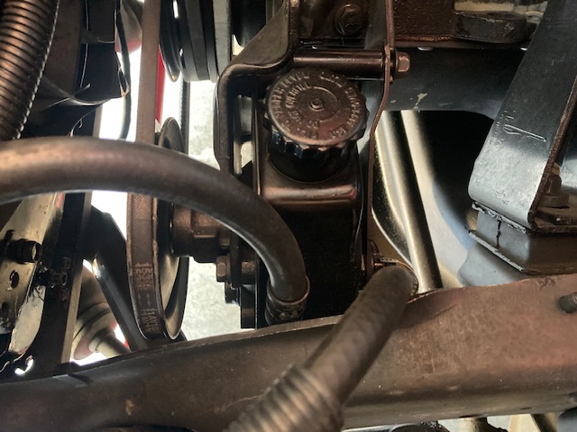

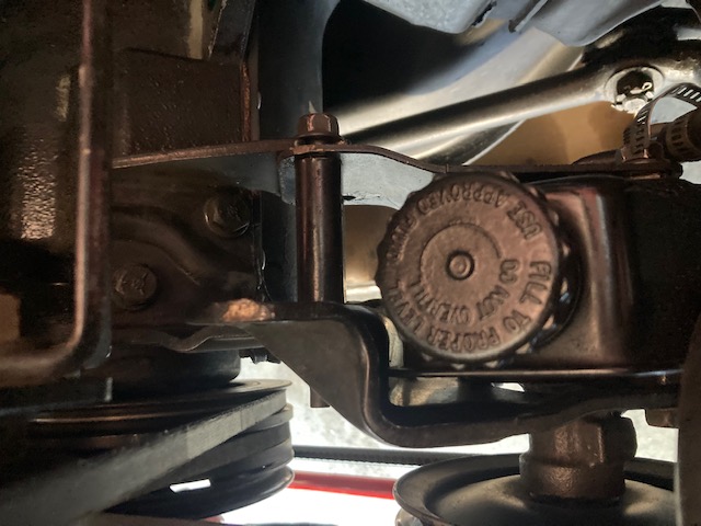

PostPosted: Wed Aug 31, 2022 12:50 pm
Posts: 3857
photos
the block mount looks the same as what I have, the actual front and rear pump mounts a different and are moving the pump canister forward.

Hello All,
First, apologies for the delayed update - conflicting priorities. :-)
Many thanks to Supercharged for the pictures, they immediately 'solved' the issue for us. Turns out that the current brackets were
the correct ones, but the pulley was incorrect! The pulley on the pump had the incorrect offset (too shallow). Located the correct pulley -
problem solved!!
