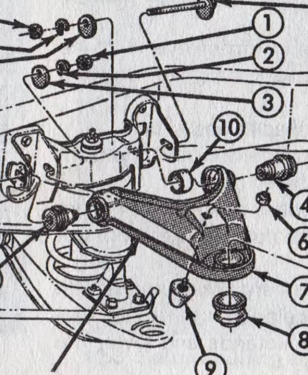

Rebuilding the front end of my 78 d100. Fsm shows a spacer/bushing? on the inside of it. Is it needed and does it goes on both sides? In the pic it’s number 10.

It is a retainer for the control arm bushing, and it is only used on 1 side, some A bodies used them also. I am not sure why Chrysler used them.
