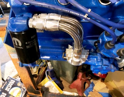

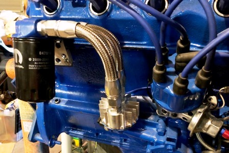

I’d like to relocate the oil filter in my A100 with the /6. Anyone ever do this? Is there a preferred kit? Thanks,Steve.

I would think any of the universal oil filter relocation kits from speedway / summit / jegs would do the job or the Australian oil pump.

Decide where you want it and just buy any of the kits out there you want. I don't know if any of them are all that much better than any other one. Matt's is a neat set up also.

Hey Matt, really like your setup. Sent you a PM. Thanks,Steve.

Well guys, here’s my idea of remote filter mount. Not 100% complete, but you get the idea. Thinking of maybe trying some AN fittings, but may just leave it alone.

Nice set up! I like it. :D
