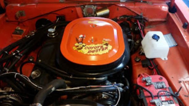

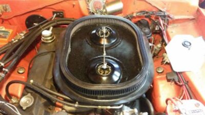

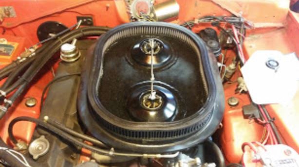

There was a recent post with 2 X 2 Weber conversion.
Also many interesting air cleaner set ups.
This is my favorite.
