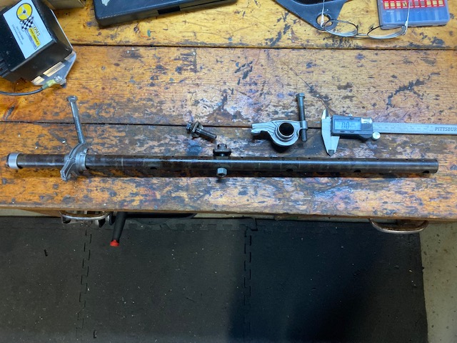

Looking at this as a math problem and using the tools and the parts that I have available, at the moment.
The tools; a Harbor Freight digital caliper, sometimes it is what it is.
The parts; shaft and rocker arms from Mike J that are used on the flow bench
1) Rocker Arm Shaft diameter; .8750
2) Edge of the center of the rocker arm shaft bushing to the outside edge of the adjustor bolt; .9250
3) Adjustor Bolt diameter; .3700
4) Edge of the center of the rocker shaft bushing to the center of the valve side of the rocker; 1.680
* Shaft diameter .8750 1/2 of that is .4375
** Adjustor bolt diameter .3700 1/2 of that is .1850
*** Edge of the center bushing to the outside edge of the adjustment bolt; .9250
.9250 + .4375 = 1.3625 - 1/2 of the adjustor bolt = 1.3625 - .1850 = 1.1775
so 1.1775 is from the center of the rocker arm shaft to the center of the adjusting bolt.
****edge of the center of the shaft to the center of the valve side rocker radius; 1.3680
***** 1.3680 + 1/2 of the shaft (.4375) = 1.8055
from the center of the shaft to the center of the adjusting bolt 1.1775
from the center of the shaft to the center of the valve stem depression radius 1.8055
proof;
1.8055 +1.1775 = 2.983
2.983 / 1.8055 = 1.65 ratio on the intake side.
so why is this not the 1.5 ratio that is commonly quoted?

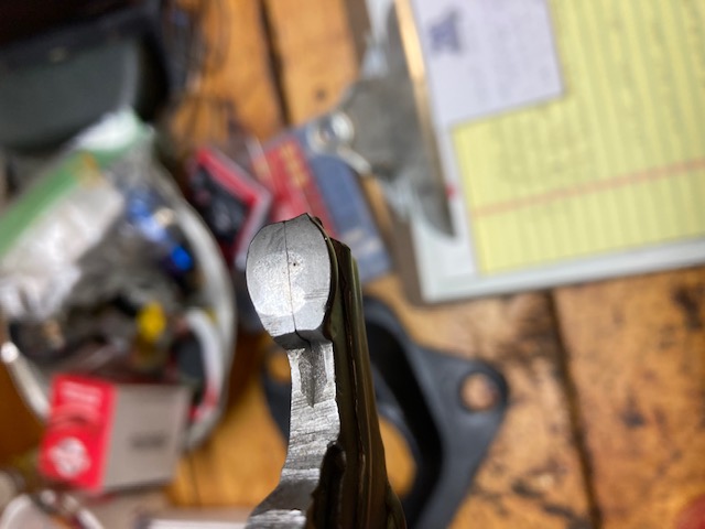

see photo #2. That is a rocker arm used extensively by Mike Jefferis and myself for slant six head flow testing.
Note that the radius side of the valve has two distinct patterns. I just noticed this today. When measuring from the center of the inside pattern,
I can mathematically get to a 1.5 ratio valve lift. When measuring from the middle of the outside pattern I can get mathematically to a 1.6 ratio valve lift.
This make me think that the variability of the slant six rocker arms, being 1.5 to 1.6 ratio may have a bit to do with the angle of the valve guide and the corresponding valve tip, although the ramp angle of the intake side rocker arm ramp would also come into play. An additional likely factor is valve stem length. I have ran multiple flow bench cycles with valve that have stems longer than stock slant six valves. Certainly Mike J did also.
I think the values presented are accurate, considering the hand tools used. Hope this helps.
