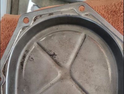

I have a cam walk issue on the "street engine"

The reason I said a plastic material was because I ran one on my 440.
An old racer gave it to me.
It just slipped over the bolt head on a single bolt 440 cam and sandwiched the cam and timing cover.
It was some kind of plastic.
I have some wear marks on the back of my cover, so I know the cam is walking forward.
