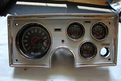

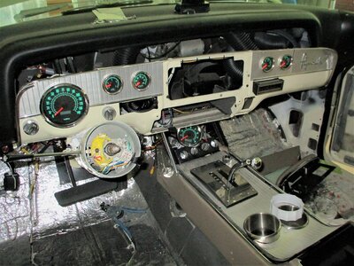

I went with a modern gauge replacement on my '64 Valiant. Pricy and lots of work, but I'm satisfied with the results.

Did you do the new gauges yourself? If so what kind were they. I think they look right at home. :D :D

They are from "New Vintage USA" and are made in Michigan. I shopped several gauge manufacturers and decided the NV faces looked the closest to the original '64 Valiant gauges.
I liked them so much that I am also using another set of a different series that looks era-appropriate for my '56 Plymouth project.
ttps://newvintageusallc.mybigcommerce.com/
