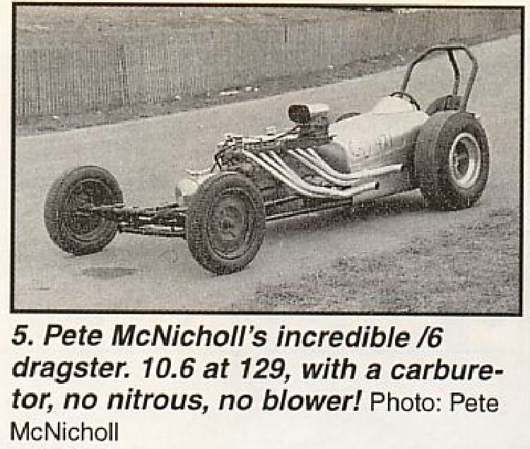

Here is a picture of Pete McNicholl's dragster.
Using a Hyper Pak intake and long tube headers he went real fast a long time ago.
Pete was a Ramcharger, they applied ram tuning to engines.
I agree on a V8 I am just not as convinced on an inline 6... I am just can't convince myself there is enough interaction between cylinders 1,2,3 and 4,5,6 to matter.
