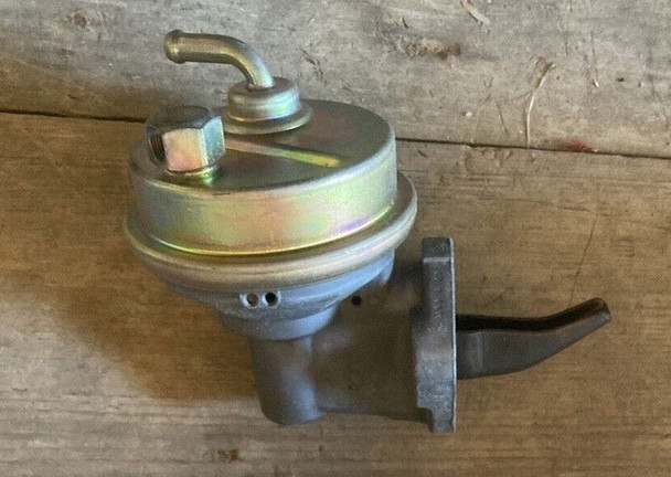

Get one of these—the kind with the round stamped-steel "hat", like this:
Also, It will also be a good idea to service the oil pressure relief valve to make sure it's doing its job, as described in these two threads: thread 1, thread 2.

Hey Dan, thanks for the info! :D :D Most of the new ones are absolute junk and the fittings twist and leak and are just like they are made of tin foil. Anyway, my question is about whether or not there will be any problems with the AC ones that look to be 20-30 year old stuff? Will the diaphragms still be Okay in them? Thanks again!
PostPosted: Sat Mar 25, 2023 5:03 pm
I never had to re-replace one after installing it, even after pulling it out of a well-worn old box, even well into the gasohol era. It's possible you could have an early failure, but early failure is practically guaranteed with today's Chinese lumps of fuel pump-shaped garbage.
