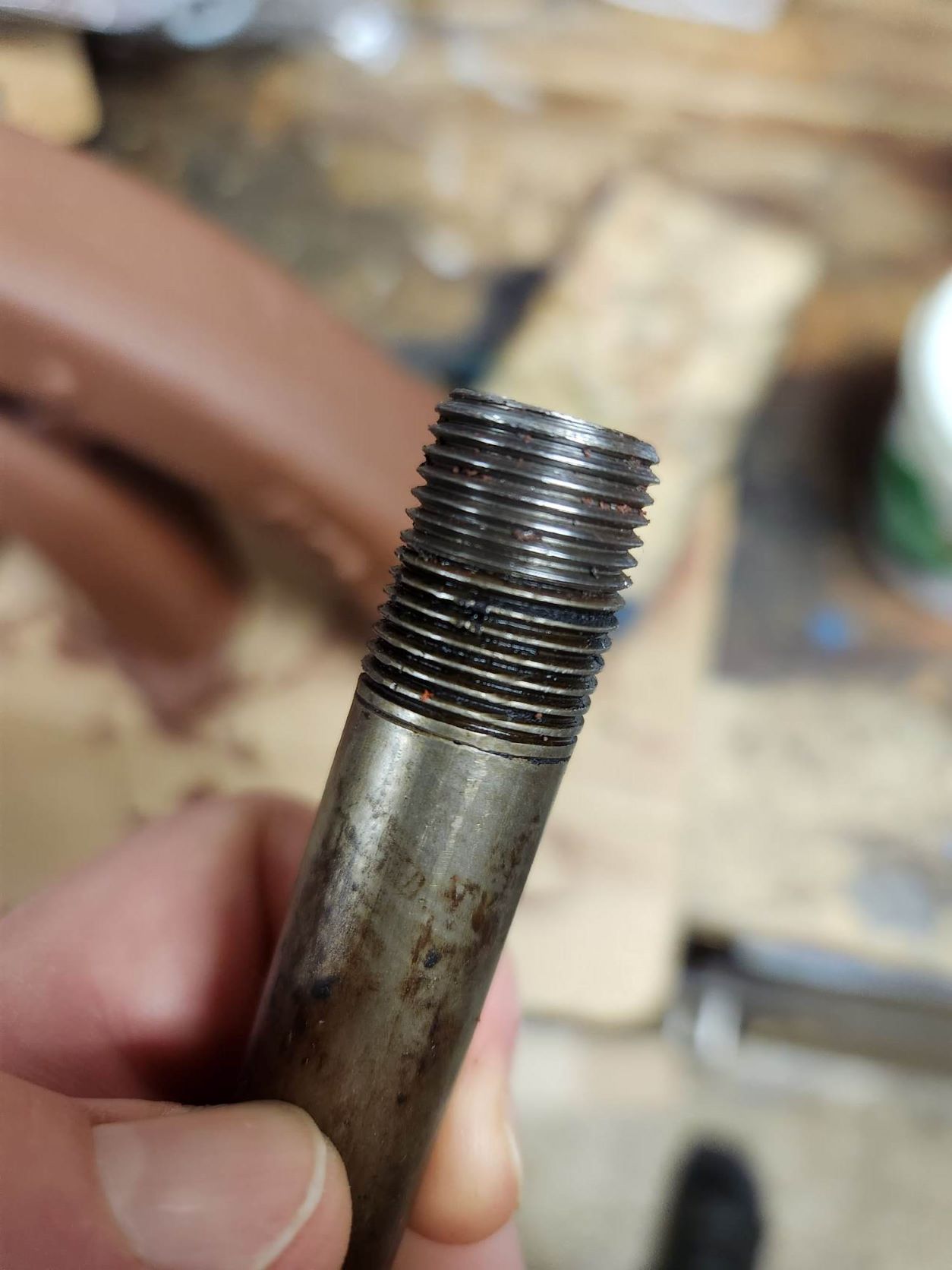

I believe its to short because it has to be screwed in farther to tighten cause of the thread stretch. This is what it looks like, i was trying to find a die nut to try to salvage it. Just not sure of the size pipe thread, was hoping someone knew for certain.

You are on the right track, the pick up screen head should interfere with the bottom of the pan. Since the tube is going in too far here are a couple of options:
1) weld a couple of spacers of the appropriate thickness to the bottom of the screen head to make up the distance. A couple of light tack welds would be plenty to hold a spacer. Adding spacers to the bottom of the screen head to get it off the pan floor while maintaining contact for support is a racers trick used to assure good oil flow to the oil pick up head.
2) use a Loctite product to set the oil pick up tube position, with out the tube threads being mechanically tight. The typical Loctite that you find at a big box car parts store is not what you want to use. You would want a Loctite product made for that purpose. Call the Loctite tech line and tell them the issue, they will have some thing that would work. Then shop e bay or on line to find it.
3) if finding the absolutely correct product to lock the NPT threads is not your cup of tea, put JB Weld or any other temperature resistant epoxy on the threads. Be sure with either 2 or 3 both sets of threads are absolutely clean and dry.
I am suggesting these fixes because I don’t know how one would re cut tapered threads with out making the taper less of a taper.
