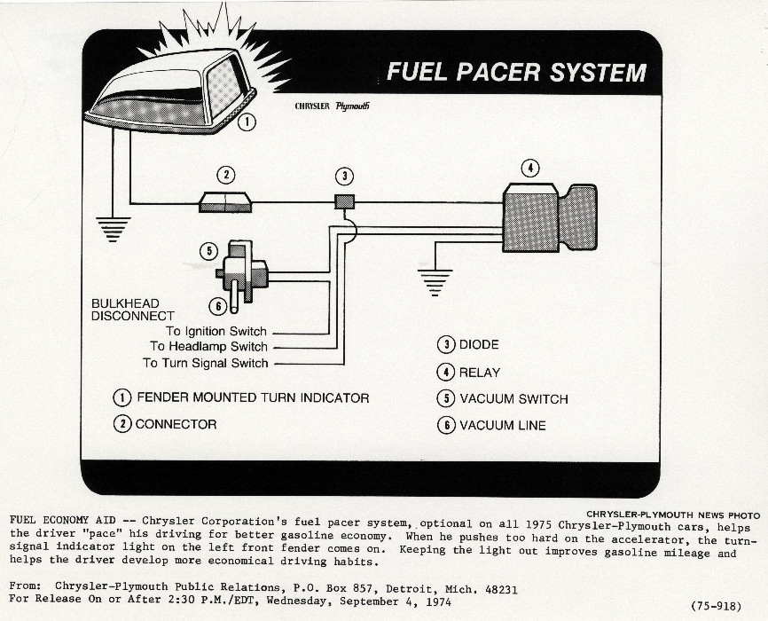

The resistor for the 3 wire left Fender turn signal indicator is bad on my 75 valiant. I took it in to a shop, and they lost the resistor. HELP! What do I need?

Edit: the 75 had what was called the Pacer fuel management system, which illuminated the same bulb. It was working when I took it in

If they can't or won't clean up after their own mess and you have to wipe their butt for them, then get readin'; here are two items to get you started. There's no resistor in the system, but a diode. That makes sense, because a diode would allow the one light to do two functions, while a resistor would not. Shouldn't be hard to reckon out the specs on an off-the-shelf diode, based on a 3-watt bulb and 14-volt electrical system.

Thanks, Dan. You da man.
