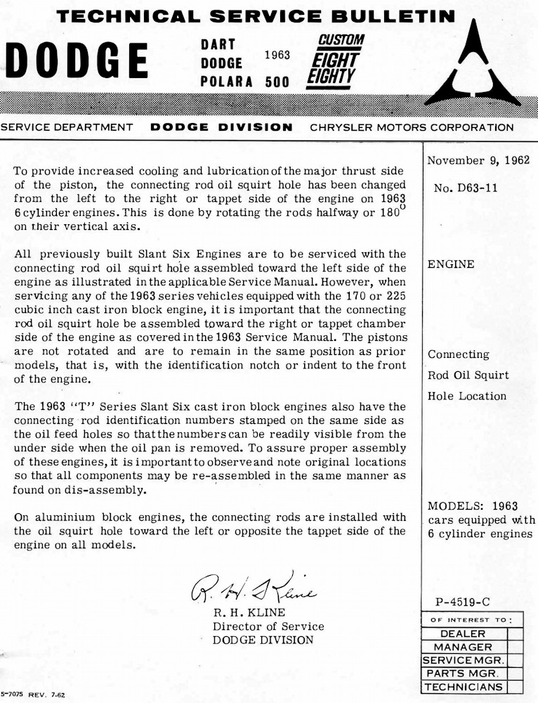

I actually found another seemingly oe rod with the squirt hole facing the incorrect direction too. It was machined correctly but hung on the rod/ piston backwards. Not sure if it makes a bunch of difference.
Y'mean like this?

I find it weird that rod oiling hole directions were changed.
It seems like it used to be cut and dried but now who knows what is right or wrong.
Pin oiling or tappet oiling?
PostPosted: Mon Nov 27, 2023 9:16 pm
Posts: 25083
It seems like it used to be cut and dried but now who knows what is right or wrong?
My guess—don't quote me on this—is that the answer to this question is "Whoever has read this TSB".

It also means that likely we don't need an oil spurt hole at all! I remember the first batch of K1 rods did not have this and people had trouble with this. I imagine V8s never had this, and so the K1 folks just left it out, and it would have almost certainly been fine, especially with modern oils.
PostPosted: Tue Nov 28, 2023 7:24 am
Posts: 2243
Location: Everett, WA
I would think that if the squirt holes were not needed, the accounts would have had the entire process of drilling them out eliminated. Thus increasing the profit margin on the engines. Since those holes survived until the last \6 rolled off the production line, they must have served a purpose. Such as oiling the cylinder walls.
But then institutional inertia could also explain there continued existence.
PostPosted: Tue Nov 28, 2023 9:59 am
Posts: 25083
Gonna disagree there. "Things work better when the oil squirts over here instead of over there" is not the same as "Oil doesn't have to squirt anywhere in this vicinity".
Every machining operation cost Chrysler money. Chrysler never met a penny they didn't pinch as hard as they could. If the oil squirt hole weren't needed, this TSB would have said it had been eliminated.
