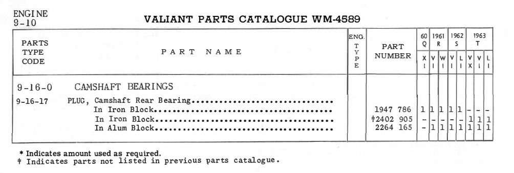

Author:  SlantSixDan [ Fri Dec 29, 2023 12:57 pm ]
Post subject:  Re: Camshaft plug size differences? what is the switchover year?
Looks like new plug ø for '63 on the iron blocks. That would make sense, because it corresponds to the new iron block casting numbers for '63—and that mysterious conrod oil hole about-face we were talking about.
Author:  Greg Ondayko [ Fri Dec 29, 2023 1:49 pm ]
Great, thanks for the Info.
Now I will know to never throw out those big cam plugs!
