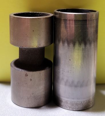

I guess I was remembering a story Seymour did in SSRN.
I do have a set of lifters here that came with an aftermarket cam.
They are a little longer but seem to have the same lobe to ball socket dimension.

Thanks, Stan and all. Looks like the body is longer but a bet the socket-to-face is the same.
