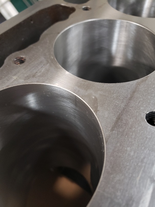

Noticed the head bolt holes were not chamfered by the machine shop after the block was milled. I have searched and not found a topic on this. How much of a chamfer should there be?
Author:  Rick Covalt [ Mon Mar 18, 2024 9:37 am ]
Post subject:  Re: New thread (why not) 83 oil usage Now engine assembly.
I am not sure that it matters. I never did anything to any of the blocks I had machined. Especially if it was just a small cut.
Author:  DadTruck [ Mon Mar 18, 2024 12:15 pm ]
The chamfer reduces the possibility that a small burr could be kicked up in handling or assembly.
An edge break is all that is needed.
A good sized chamfer is needed a the top of the cylinder bores to help guide the piston rings In during piston insertion.
If a lot is cut off the head / block be sure to verify that the head bolts don’t bottom out. Hardened washers can be set in under the bolt head to restore the proper bolt depth.

I'll check for a chamfer on the bore. Some paint on the block.
Author:  Jimmy [ Wed Mar 20, 2024 4:09 pm ]
Looks like about a .01 chamfer
Just by eyeball. Didn't get the depth mic out. Good enough? I could search but who doesn't like more pictures?
