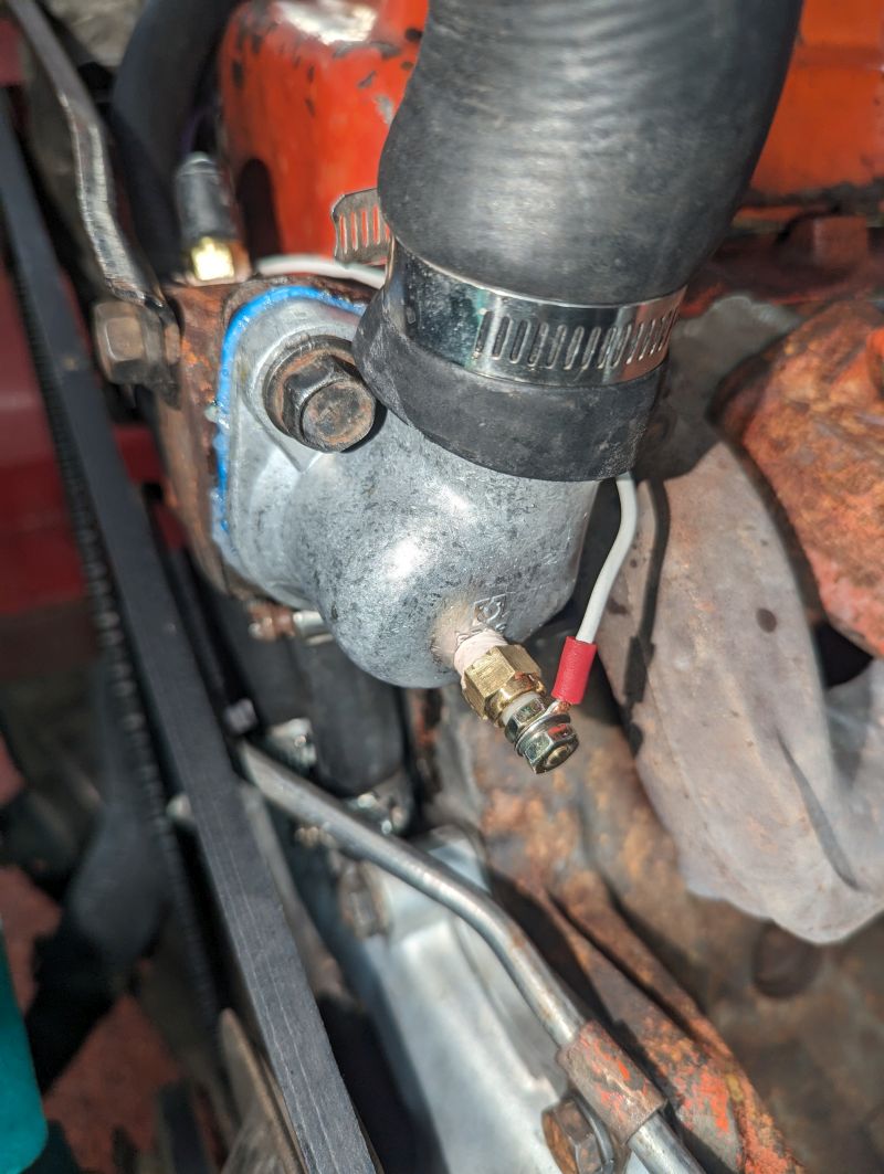

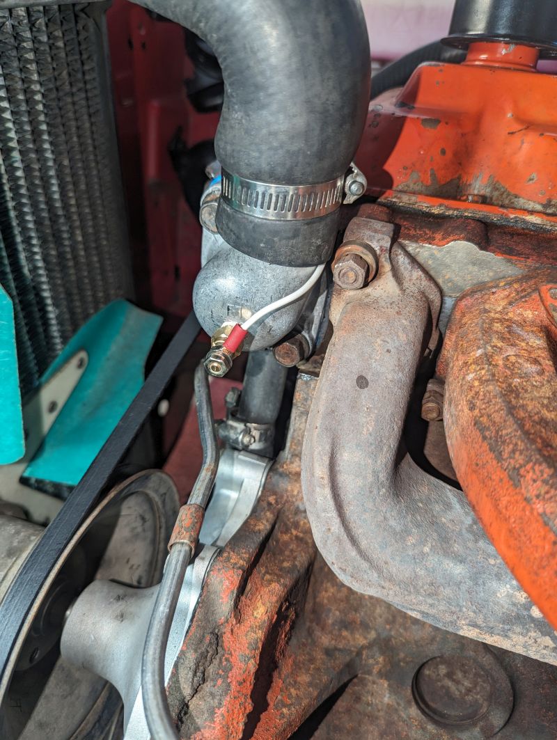

PostPosted: Sat Mar 30, 2024 10:03 am
Posts: 59
Location: Murrells Inlet, SC
Car Model: Dodge Coronet 440
I finally got done with this job. I was waiting for a non-busy day with nice weather to work outside. See the pics. New thermostat housing with aftermarket temp gauge installed. I also switched out the thermostat 180 for the 160 that was there and replaced the coolant. Both gauges work fine, one on either side of the thermostat. Thanks all for the suggestions.
Jon
