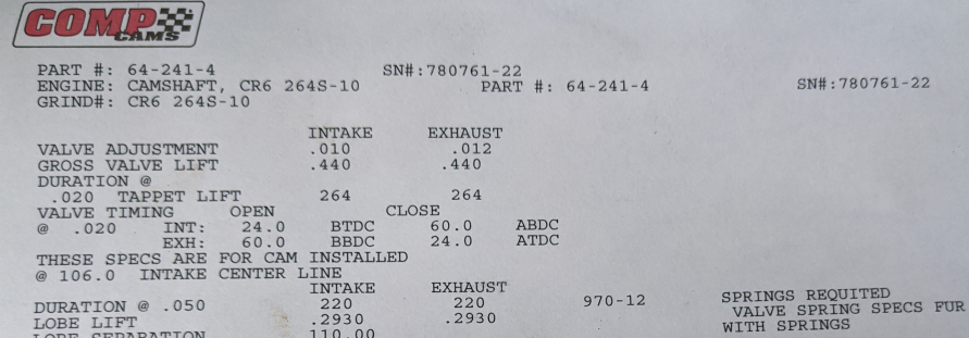

You bring up some valuable questions, none of which I've read about in any of my manuals. I'm glad you brought them up, since I can share my shallow knowledge and learn something!
1) I purchased the truck and it was running, but it was smoking like a BBQ and the inside revealed it had been rebuilt numerous times before. From researching the block, I found it's a very early 225 with 3 frost plugs, spark plug tubes, and a serial number that is before any sort of meaningful numbering scheme. From what I could find out, this means it's probably very early sixties but apparently you can't determine a year on the early ones. So, with that being said, it's solid lifters under there. The cam is a new cam with a mild profile - here is the cam card:

2) I had no idea it was a mismatched valve cover. From what I know about the truck, I suspect it was assembled by a diesel shop to be used as a parts runner and they probably used what they had. So, it isn't surprising that it didn't come with the original cover. I'll read up on your reference and determine what to do to make sure the cover gets corrected in some way.

Oof…that Comp cam. I fervently hope you have better luck with it than others have.
For engine info, look for a stamping on the block deck, below the frontmost spark plug—visible with the head installed. If the block has been heavily decked it will have been erased, but if you find a stamping there it'll help figure out what this engine (or at least the block) came from.
What experiences have you heard of regarding this cam? I should probably know what to look out for.

Enough-more-than-one instances of the engine not running satisfactorily/not up to expectations, no matter what was tried. In general I dunk on Comp because last time I checked (admittedly, quite awhile ago) they just more or less use Chevrolet lobe profiles on everything they offer. Everything relevant to us, anyway. That by itself doesn't make their products poopy, but it does mean their cams don't take account or advantage of the larger-diameter Mopar lifter, nor the other Chrysler-specific engine characteristics. That 0.012" exhaust tappet clearance spec is rather small; you might find yourself wanting to open it up.
Ah - understood. I don't recall why I selected this cam since it's been awhile since I purchased it. I vaguely recall finding a well-rated cam across the board wasn't especially easy or possible, but I'm not sure why I settled on this one.
