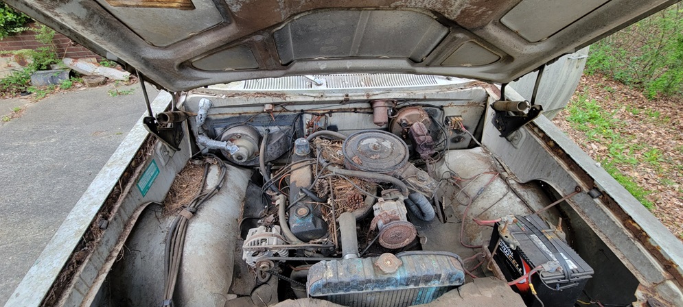

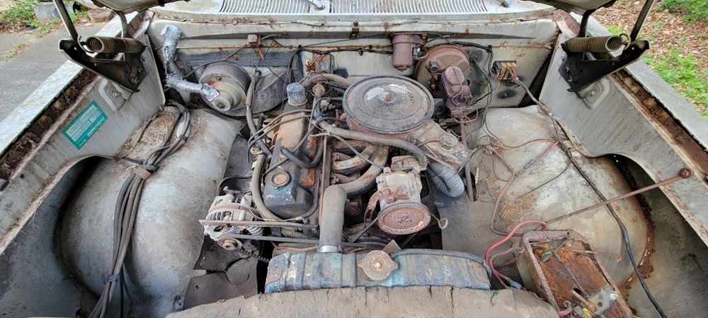

Joining up to learn about the slant in the 1972 D100 I "accidentally" bought. It's a funny origin story. The truck was donated to my gun club and was used as a shooting position (engaging targets out the windows, bed or crouching down behind the body) a few times. It quit running 10ish years ago and just sat behind a storage building. I was at a meeting to plan a big pistol match this year and there was mention of using the truck again but it didn't run. I said I could probably get it running. Then it was mentioned the windshield would have to come out for the planned use. That hurt my soul because I thought it too nice to destroy like that. I obviously have ZERO poker face because the match director could tell I didn't like the idea and then he asked exactly the wrong thing of a car junkie like me: "well, do YOU want it?". The club needed to figure out what to do with it because we're relocating later this year. So the board voted to "sell" it to me cheap. Cheap enough I'll need a gift letter if I ever get to the DMV to put it back on the road.
I've managed to get it to crank. Had to replace the tank pickup. But the Holley 1 barrel leaks so it'll probably need a rebuild. I moved it in reverse and am unsure that 727 is happy.
Right now it won't crank again. It tuns over a bit and the starter disengages the flywheel and just spins. I probably need a fuel pump too. The current one seems to lose its prime and it takes forever to get fuel back up from the tank. I had to "help" it prime by siphoning through the fuel line when I did get it to start.
