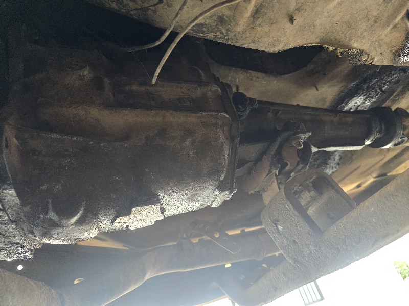

Pic of the trans.
File comment: This is the picture of the transmission

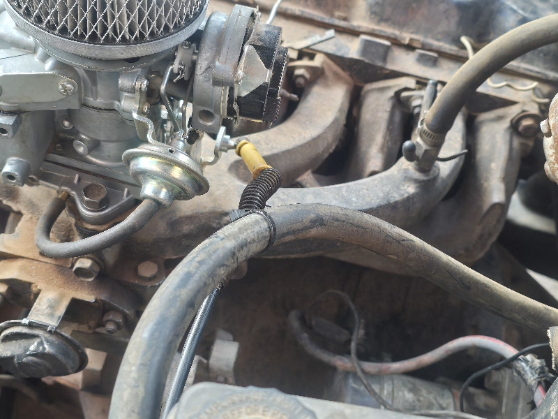

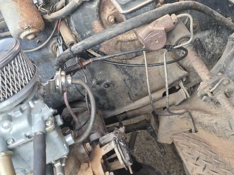

I don't have a timing light I'd have to buy one. It's not the best set up since I'm not the best at modifying stuff that's mot meant to be. Does anyone have a 1bbl carb for the slant six something new old stock or 2 bbl with the intake. It's hard to find stuff for slant six. Pics below. Or how could I fix my current set up.

From the picture you have a serious problem with the throttle cable mount. You must have the cable housing mounted firmly to a bracket that holds the cable in place when you push the throttle. It appears yours is zip tied to other flexible items. You or someone who can help you will have to fabricate something solid. A cheap timing light would be a wise investment or at least borrow one.
I tried using the same mount at the bottom so it made it worse. Is the length of the cable too long as well? I think it's 32. I'll look into buying a timing light. Would you know of anyone that has a 1bbl carb for sale that would work so I can just buy the oem cable. If jt doesn't plan out. Also is the length too long?

The length of the cable is not the problem. It is how it is mounted. You can have a longer than needed cable and it can work fine. It just has to be mounted correctly and not flex.
If you don't have some fabricating skills you may be better off finding an original carb and cable set up. But finding 40 year old carbs in good shape can be a pain also. Maybe someone on here has one?

Flex as in the bends what do you mean by flex. Also that would be great if I could find a new.old stock one. What type of transmission do I have were you able to tell?

The main problem you have is that the end where the mounting tab is must be mounted solid. No give. The length of the cable can give some flex or deflection too. But that is not you major problem. I have a cable as long as yours and it works fine. Get the end mounted correctly and see if it pulls your throttle open. The height of that mount in relation to where the cable hooks to the carb needs to be right as well. Move the throttle by hand out at the carb. See where it starts and stops and the arc that it moves through. Generally you need the cable mounting point to be a little below the point where it connects to the carb. That way it can fully open the carb.
