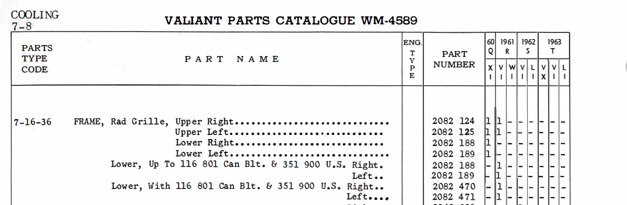

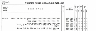

The '60 and early-production '61 Valiants had different grille surround parts, so the fitment groups for parts like this are ['60 + early '61], [later '61], and ['62].
