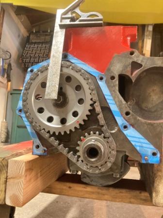

On my engine reassembly, I'm stuck with the timing. The cam pin (and cam gear slot) is pointing straight up and is exactly square with the top of the block. The crank key is pointing exactly straight up. The number one (and number six) piston is exactly TDC including any adjustments for dwell. Why aren't my timing marks aligned on the gears? If I move the camshaft slightly clockwise so the marks line up the camshaft is going to be cocked slightly to the right and is no longer pointing straight up. Is it more important for the cam and crank to be in the correct position or is it critical that the marks line up too? Thanks for the help. (I added a photo. Hopefully it uploads ok)
I don't know that it matters about the slot being straight up? But you need to degree the camshaft and check it that way. Most new camshaft / gear sets do not line up. They can be 5-15 degrees off. You are going to need a offset bushing installed in the cam gear and correct the timing that way. Your next problem is the gear has a slot instead of a hole that can be drilled to accept the offset bushing. I never use those gears.

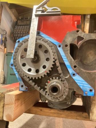

I can get the marks to line up by rotating the cam slightly to the right. The key in the crank is still pointing straight up and the the #1 piston is still TDC. Does it matter that the cam is cocked slightly to the right?

You won't know if it is correct until you do the cam degreeing process. All you know now is that the dots line up. You do not know if the valves are opening at the right place.

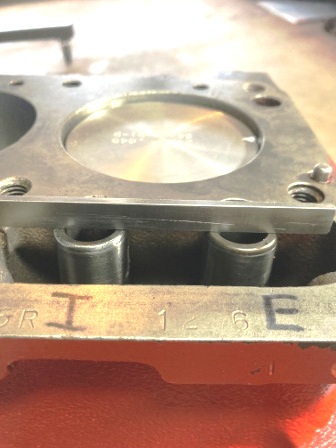

When I rotate the engine 180 degrees, TDC #1, my lifters are dead even (up/intake and exhaust open?). I think I'm good, correct?
You are not measuring what needs measured to tell you what you want to know.
You said you degreed the cam, correct? What number did you check it at for the Intake Center Line. That will tell you if you are advanced or retarded or just right.

He also has slop in the timing chain. Is this a new timing chain?
