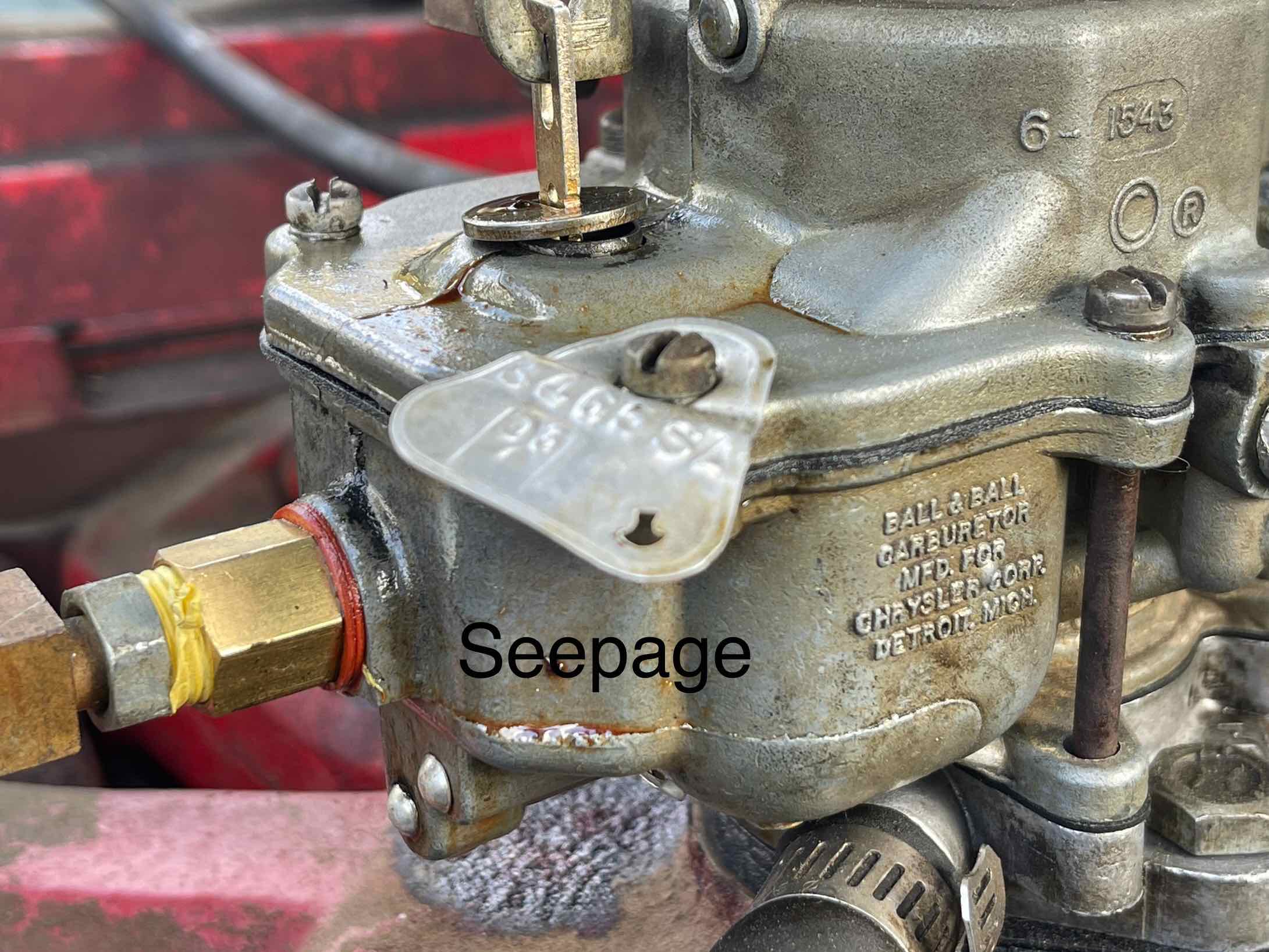

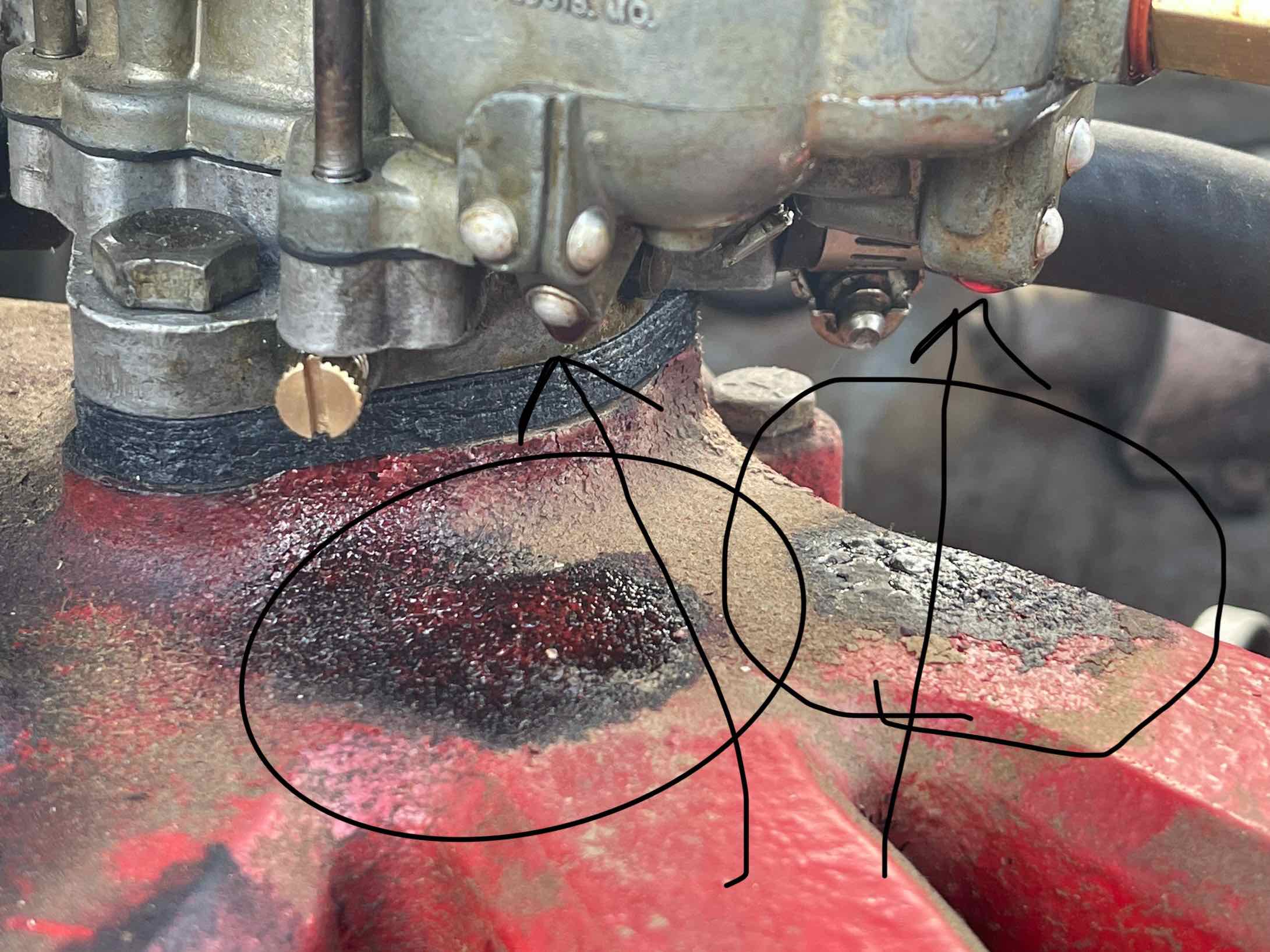

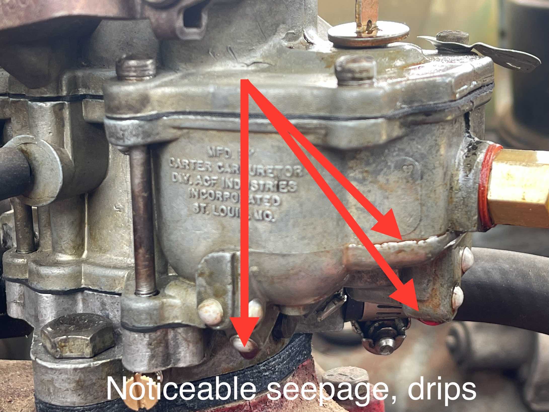

PostPosted: Sat Apr 26, 2025 4:34 pm
Posts: 852
Location: Los Angeles, CA
Alright, then it sounds like your carb is emptying out overnight. Could be draining back thru the inlet via a less, than-perfect needle/seat seal and leaky fuel pump valves…could be seeping thru an imperfect carb body plug below fuel level…could be boiling off out the bowl vent.
This would appear to be happening. Telltale drips on the exhaust manifold below certain carb body plugs I’ve never before removed indicate leakage. See the arrows. Also, the entire carb body has a rather “wet” appearance that I don’t recall it having on prior rebuilds. I see what looks like seepage happening at cast joints :shock: :(
