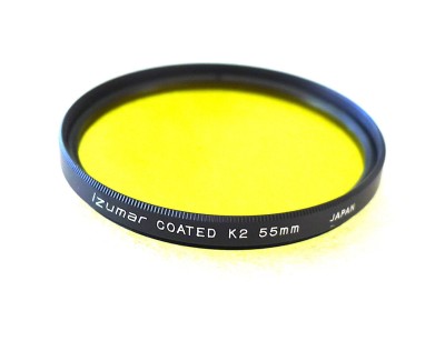

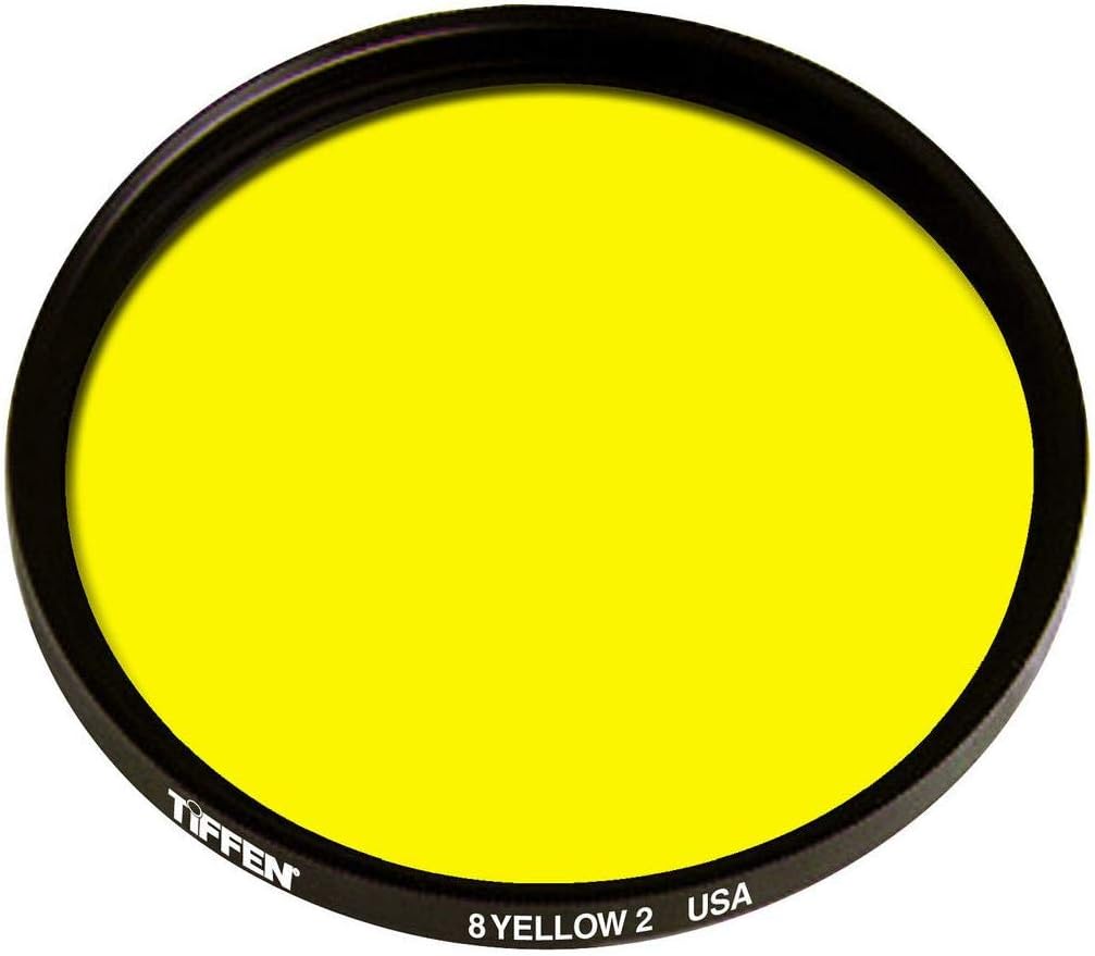

This is a "sharp cutoff" or "highly selective" filter: just about zero transmission of the blue-to-violet, and over 90 per cent transmission of green-yellow-orange-red. The result of having lenses done with this dye should look just like these camera lens filters, type "K2" or "Y2" (other designations from some makers):
See how the yellow colour is saturated, not pale, but it is yellow, not leaning at all toward orange.
