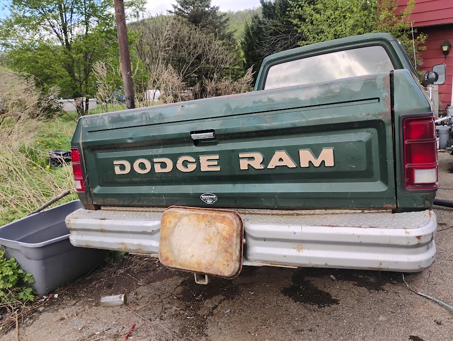

PostPosted: Thu Oct 22, 2026 10:39 am
Joined: Sat Feb 21, 2026 6:34 am
Posts: 19
Car Model: 1981 Dodge D150 and Jeep ratrod with Slant/727
I know this post is old, and not sure if it would fit your application.. But I used an 80's D150 low mounting power steering pump, then turned the smog pump mount into a driver's side alternator mount for this build..
https://photos.app.goo.gl/4gvNRZu6jo9VP6NT8
