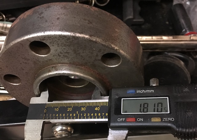

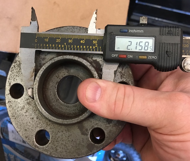

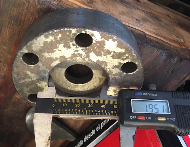

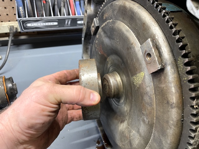

This is what I have:

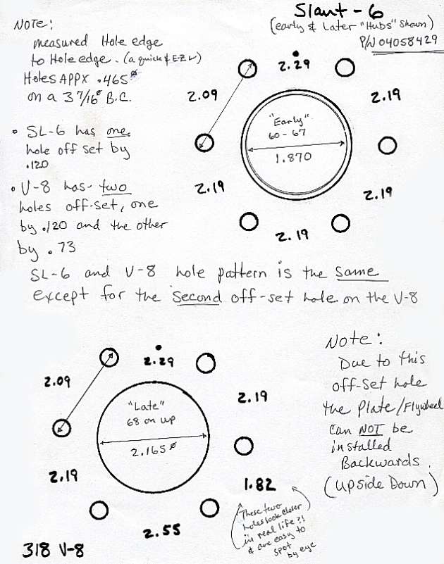

And here are some notes about crank hub sizes I stole from somewhere:

The pocket on the side of the crank spacer with a raised lip fits snugly over the snout of the A500 torque converter.
I don't have a loose slant six crank or motor, but the raised flange on the back of a 1999 Magnum 360 crank over which the flex plate fits measures 2.158 inches from outer edge to outer edge. That is exactly the same as the diamter of the raised lip on the crank spacer.
So my question, then, is does the pocket on the flat side of the crank spacer fit over the flange on the slant crank? It must, because the flex plate must bolt directly to the torque converter and the raised lip on the crank spacer fits the hole in the middle of the flex plate. So I think I have the crank spacer orientated correctly in the picture above. If that is true, no spacer ring is needed, just a quick trip to a machine shop with a lathe to open up the pocket on the flat side of the crank spacer to 2.165 inches.
Sounds like I just confirmed what Lou already told me! Does this all sound correct?
PostPosted: Mon Sep 22, 2025 10:47 am
Posts: 17634
Yes, that is correct. Just lathe it out to lightly slip or tap fit the spacer onto the Slant crank snout. 2.165" sounds too big to me. You want it at 2.159" assuming your caliper is right. BEST would be to carry a late Slant crank to the shop that will do the lathing and tell them to make it a light slip fit. 0.006" in diameter difference will not center it well enough and you'll have a vibration.
