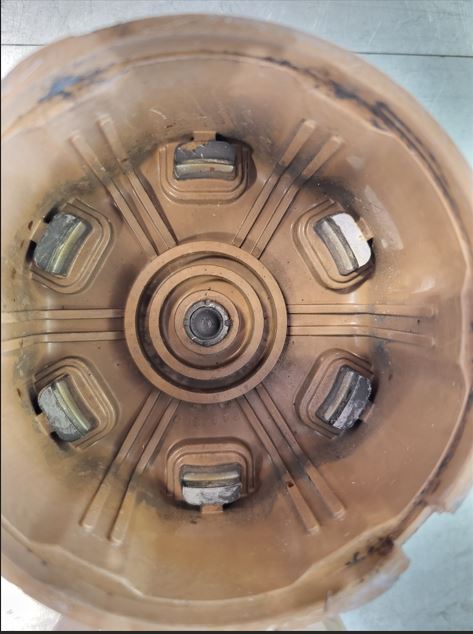

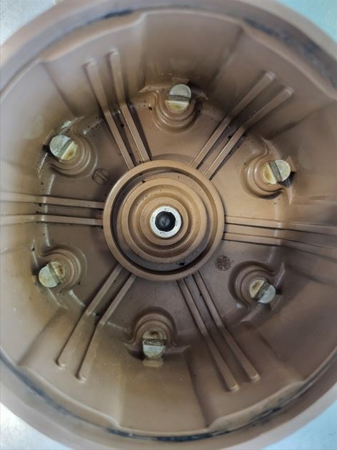

Ok, I have never see this, maybe you have.

that top one is new on me. don't think i have ever seen those flat tabs on mopar caps.

Top cap is a 2444 690. That was the improved version of the first wide-contact distributor cap, a black one named 2098 765. The tan material, introduced in the '64-'65 timeframe, has higher dielectric strength (greater flashover resistance) than the previous black material. The wide-contact cap was used with rotor 2098 770, which had a necked-down, narrower end contact. These parts were first used as part of a service package 2448 273 (which also included a new coil-to-cap wire) to address cold/wet starting issues. Those three parts were incorporated into new-car production. Read all about it:
These wide-contact caps and narrow-long-contact rotors were cancelled for '66, and the Slant-6 reverted to the regular narrow-contact cap and the same 1838 516 shorter/wider-contact rotor used prior. The bottom cap is a 2642 986, which was the '66 cap (the pre-wide-contact cap was a black one, 1889 424).
I like the wide-contact/narrow-rotor setup, but I've never seen such a cap with contacts made of anything but aluminum. The benefits can be duplicated by benchtop cleverness with rotors as described in this long (but worthwhile) thread.
I am running that cap on my car right now :D

Rick, do you see timing scatter?
That was the first thing I thought about.
But maybe it jumps from the rotor point to the width of the plug connection all at one time.
Do you have the wide rotor button?
Thanks Dan, new to me

I probably wouldn't know scatter if I had it! :D I use this cap and the long tip Echlin rotor. Engine has turned as much as 6700+ rpm with silky smooth operation. No problems. I picked up 3 of the caps some years ago for about $10 each. If nothing else, I figured they were old and well centered caps.
Why? The wider contacts were to make less of an air gap between the rotor and cap, across a wider range of distributor advance ---> ---> ---> less likelihood of spark going to wrong place.
I remember reading that thread when it was new. Unfortunately, the photo of the jig is lost to the bowels of Photobucket.
Rereading that thread makes me want to investigate distributorless ignition. I do not believe the quality of replacement wear parts for the slant six has gone up in the last 10 years. I am still working through the pile of tune-up parts I collected over 15 years ago, but that will run out eventually.
Remember, the exact instant of spark is determined by the instant of points opening (and coil magnetic field collapse), not by the distributor rotor and cap.
The points determine timing. The rotor and cap just point the spark energy in the correct general direction.
– Eric
Good point, I was trying to visualize the spark jumping and what it would look like.
