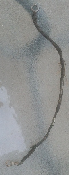

I am currently going through the process of getting all my gauge cluster lights to work properly. The problem is I can only seem to get the left turn signal light on the dash to work, no other lights at all. I replaced all the bulbs and twist connectors with new ones but I have found that the connector that connects to the bottom of the headlight switch has melted but I repaired that with a new connector inside of it. Anyways I found a navy blue wite with a blade connector behind my dash, I will link a photo, but I have no idea where it goes to. I will link photos of most of the wiring if anyone can help. Thank you -Evan

The search button is your friend:
https://www.slantsix.org/forum/viewtopic.php?t=8463
Sounds like you need to spend some time tracing wires and making sure things should should have power do and things that shouldn't have power don't.
