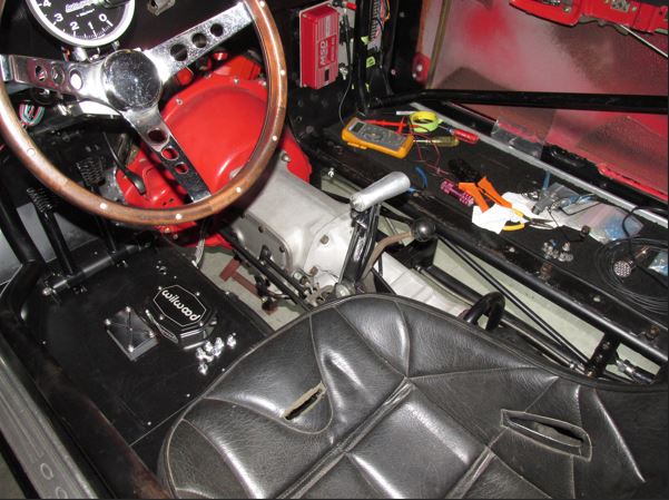

PostPosted: Mon Apr 27, 2026 1:59 pm
Posts: 9493
Well this one was supposedly rebuilt by Brewers if my memory serves me correct.That would have been 15 years ago. But it has been on a shelf for a lot of those years. Dan said he would have put a serial number on it so I'll check when it comes out. Odd thing is that Ryan told me he thought this one was the one in his Dart when he took it off the road and it worked fine.
What did you find with the brass rings Stan? This one does not grind at all. But even when on stands and you run the shifter from 1-2 & back and forth, you can still feel notchiness! Even with the engine off. Usually they would run back and forth with nice smooth action.
By the way, mine won't fall out as easy as yours! :D :D
