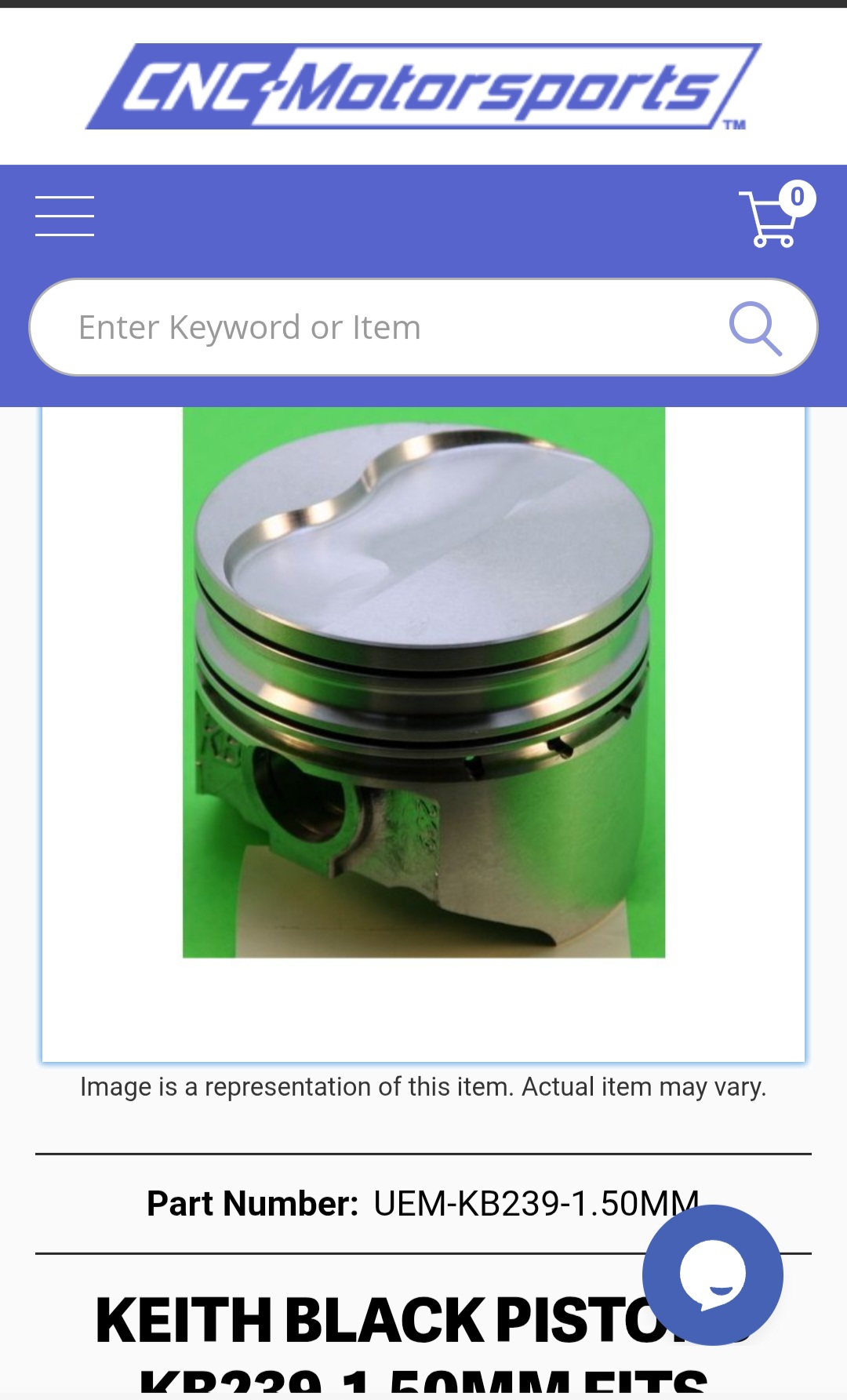

There has been a total of 0.010" cut from head and cleaned up block. According to my notes that was to yeald 9.6:1 static. The re-bore was 40 over, compression of a Fel-Pro gasket is around 0.022". The stock steal head gasket is much less thick once installed.

PostPosted: Sat May 16, 2026 7:50 am
Posts: 17641
If you did not use custom pistons or rods, then you have more like 8.0:1 compression, not 9.6. This is very important, as that cam will not work well with 8.0:1. You will need to run it quite rich to get it to run decently at all. Perhaps someone else milled the head/block before you got to them and the machine shop just measured piston-deck at TDC and head chamber to get that 9.6 number? If they were milled, then pushrods could be too tall for that. Lots to consider here, and it would be good to assess everthing before you bolt it back together. What is the lowest comfortable idle speed you could get with this setup?
PostPosted: Sat May 16, 2026 8:32 am
Posts: 9081
I would like to confirm the amount of milling. You keep saying .010 (which is 10 thousanths of an inch). That is usually just a "cleanup" cut. Do you mean .100 (0ne hundread thousanths of an inch)? That is what a lot of slanters do to get near 10 to 1 CR. Also the felpro head gasket is more around .040+ where the stamped steel OEM gasket is about .022 thick.
