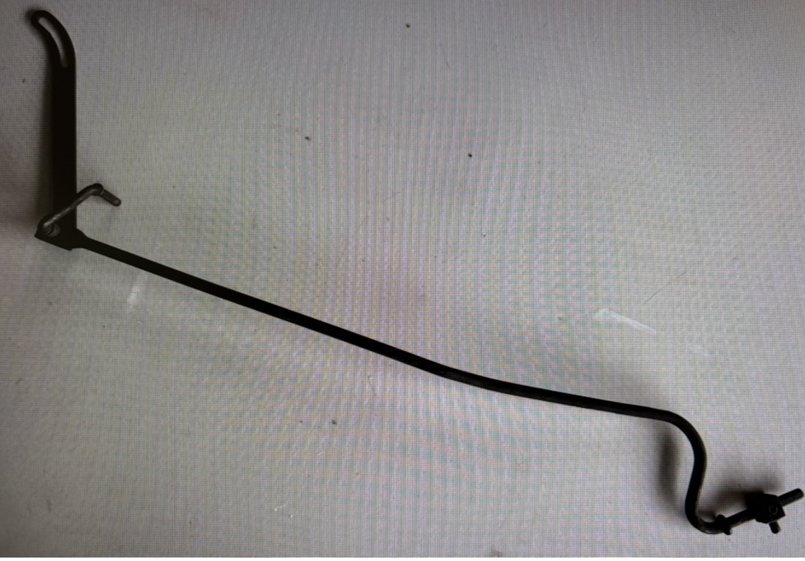

Hello everybody, can somebody identify this “super six” transmission shift rod? It definitely does not fit on my 1971 a-body (although a 1979 Plymouth Volare “super six” transmission shift rod did).
I’m guessing because of the angle that this might be for a pick up or a van? On an a-body it hits the bottom of the firewall so I think this shift rod is used on a super six application with more space like a pick up or a van.
Any ideas?

I concur that that appears to be the truck or van version of the Super Six kickdown linkage. A fairly rare piece, especially these days.
