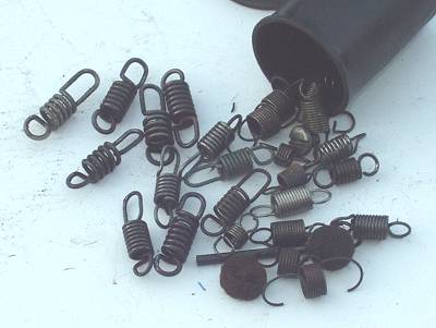

Your plot is great, however I would change your secondary spring, the heavy looped end spring. Try to find one out of a big block motor that has more coils on it and bigger looped end for a more linear progression. It is about an 1/8th inch longer than the one you have now. Doc turned me on to this spring. It will bring your curve in a little faster. I am all done with advance by 2500 and get a little more at 3000 rpm. It feels like there is more midrange power set up that way. I cruise at 2500 which is 60 mph for me.
You can take out the lithium grease on the weights and use 10-50 synthetic oil. It stays very linear year round.

Thanks for the info on the large spring. I'll have a look, but do you happen to know off hand if you can purchase these from somewhere? I don't get to make it down to the scappie (20 miles from here and dependent on others for transport) very much so if I could buy the right one new that would be great.
Do you know anything about the Mr. Gasket small spring swap?

Take a close look at the weight slots in the govenor plate to be sure ther are no deep wear spots. I have seen some with small dips in them that cause erratic movement of the weights, no matter which springs are used.
some filing / sanding usually resolves the problem.
Also remember, the spring posts are adjustable so you can fine tune the spring rates. Based on your info, go lighter on both springs. (move the outer spring post, inward)

Lots to check and do. Plan is to check the weights and smooth as needed, lube them with synthetic, try adjusting the pins and then see where I'm at.
From there it will be replacing springs and perhaps a different vac can. Just finished reading the cruise rpm post. Very helpful.
Ted, sounds like you are using the red small spring. I know there is one of these in the distributor I have here so might swap that in and see what it does.

This is the second time someone mentioned adjustable spring pins on the distributor. I must be missing something--where is the adjustment? Is it the plate below the advance weights? I have not pulled that out yet so that would explain my ignorance...

Unfortunately no one up here has these springs. I have gone to several car dealers and MOPAR Direct, no luck. We were born in the wrong era.
Yes, I did the MR. Gasket and MOPAR spring test. It was fun for about a week, but I am not into that much of a torque hit all the time. It was hard to keep the P235's from spinning. The springs are so light the engine just takes off with out allot of control. So unless your building a race car for the strip, don't go there.
I would dial in the curve to meet the needs of your cruising rpms. That will help to get best mileage.
Did you get a VC-208 can? It is a 11R. That should buy you the extra advance you need at cruise. I am running one right now and prefer it over the others. It is easy to dial in, I think I have it at 3 or 4 turns out now so it kicks in like overdrive. If I am cruising at 18" it kicks in pretty hard and gives a nice feel to the pedal as long as your not running too lean. You don't want to be driving so lean that the advance never kicks in. If you can't cruise between 15" and 18" or higher, then your too lean.
The power valve on my 1920 kicks in at about 10.5" I have my vacuum advance dialed out at that point so it doesn't ping.
Yes, the small red spring with the post rotated out to keep it tight, not loose.

I will email you Doc's distributor recurve guide that shows the spring pins. They rotate on an ecentric. You can use a small box end from the bottom to rotate them.

My thought was to look at the weights, clean them up as needed, lube and do the adjustment.
Then retest and see where the curve comes in. Might just smooth out what I have, but pretty much keep it at the same level. My thought was to bring it in mechanical side a little quicker. That way at say 2100 or so I could get into the 47-52 range. If I can get the can at say the 11R to pull in 22 at that point then I'll need to get the mechanical side to be at 25 to 30. Sound about right?
I still need to find a 400 big spring right?

Yes, if you can hit 30 degrees by 2500 that would be good. It is your preference if you want to hit it earlier. The slant puts out about 200 ft pounds of torque by 2000 rpm. Remember the old 100 to 125 HP rating was taken at 4000 rpm. We normally don't cruise up there......so we are utilizing the power from the bottom end torque. That is why the recurve can help.
Yes, I think it would be worth while to find the big spring. Send me your email and I can send a picture of it along with some others and Doc's guide.

Distributor Recurve Link
I alway grab extra advance springs whenever I have a chance, those are good to have around.
