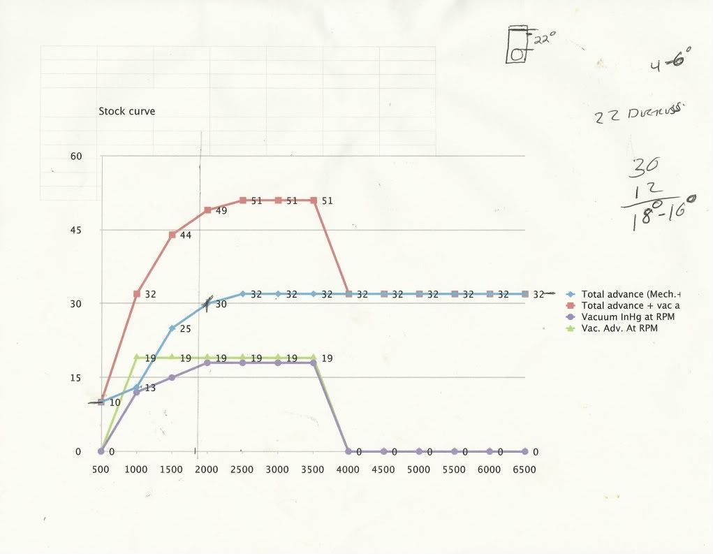

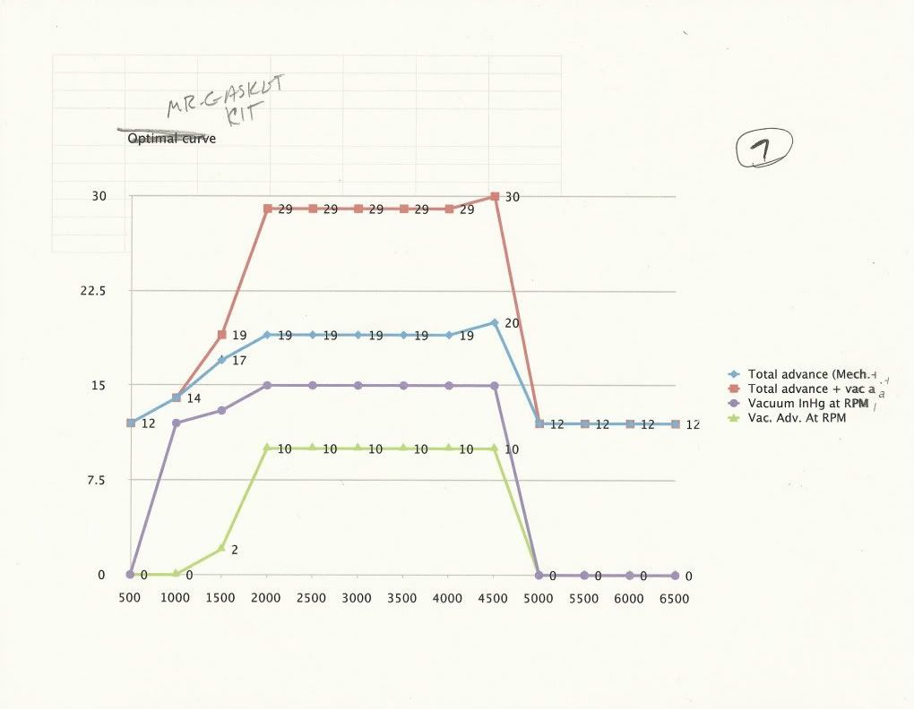

I'm in the process of learning how to recurving my distributor. I have figured out that there are two springs one stiff and one light. The light one should handle the low rpm stuff and the heavy the higher stuff. My higher spring has a slot it it that keeps it from engaging until later. When I plot the mechanical advance it gives me about 22 degrees at 2500 rpm and then levels out from there. The thing I am trying to figure out is the heavy spring with the slot is so stiff it never stretches any so it is acting more like a stop then a spring. I verified this by taking out the shaft and attaching it to my 1/2" drill and spinning it at 1500 and 3000 rpm, while watching it under my daughter strobe light. (kinda 1970's but it worked) The rpms at the distributor should equal 3000 and 6000 crank rpms. The big spring did not stretch until just over 4500 rpm at the crank. I also have a slide plate on the governor that is marked with a "15R" which I think means it should produce 30 degrees at the crank of advance. So I tried a Mr.gasket spring advance kit and I did not like it. I was kind of an all or nothing deal with very light springs. I made a spread sheet to try to visualize the curve it you want to see below. The one marked Mr.gasket was my first attempt not so good. It had maybe better low end poor top end. The one marked optimal is what I think I want to try for. The one marked stock was measured before I took it apart for base line.

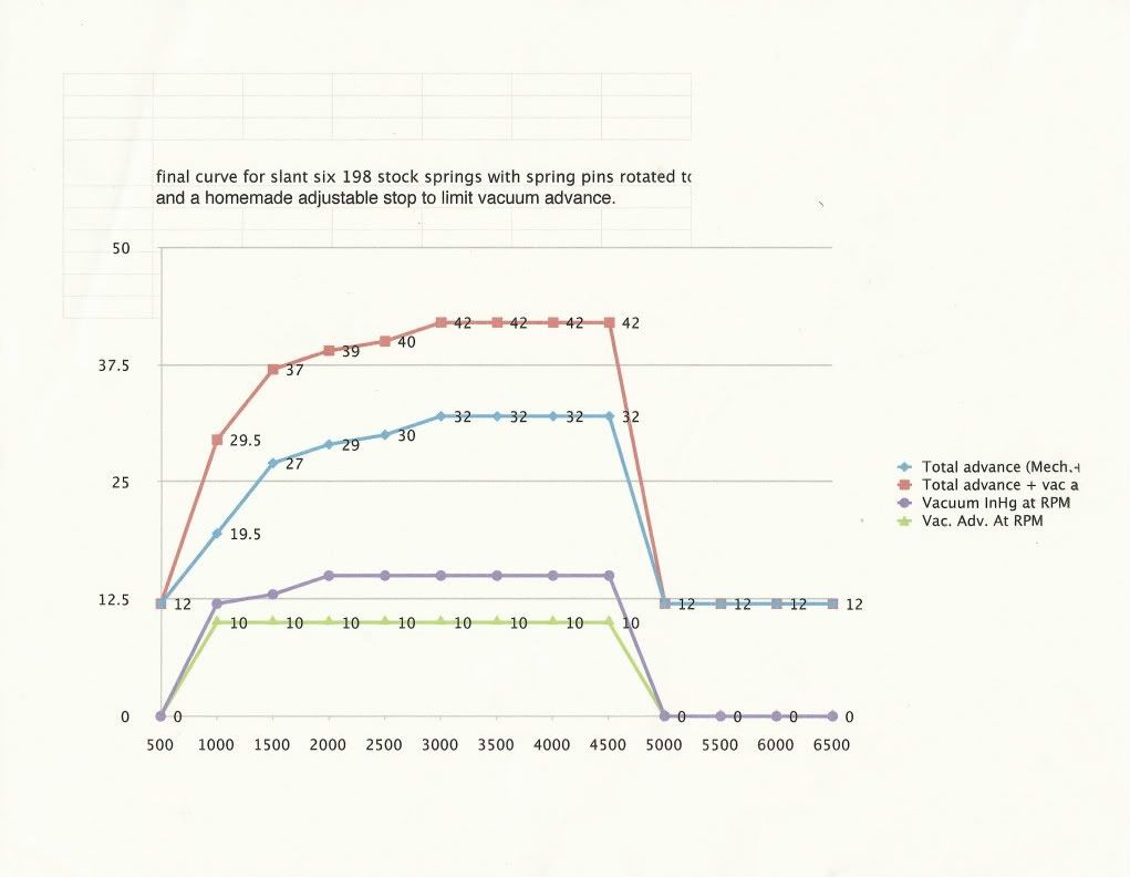

That a neat idea about the tic valve. I might try it if I can find a hole to stick it in. :) I ended up going back to the stock springs and adjusted the pins that hold the springs until I got the max total timing I wanted. I then drilled and tapped a hole in the side of the distributor level with the vacuum advance plate. and screwed a bolt and lock nut in it. The bolt hits the vacuum advance plate and stops its motion depending on how far you screw it in. This let me adjust the total vacuum advance with the turn of a screw and I could adjust the point were the vacuum kicked in by using the allen wench adjustment on the vacuum pot. I ended up with this curve after I was finished. If I get some more energy I may try to get some more springs and see if I can get what I want a more proper way. I think it is close to what Doc recommends from what I have read on this site. If anyone wants a excel spreadsheet that makes the graphs below, just tell me and I can send it to you. If you map the vacuum advance and mechanical advance the spreadsheet will give you curves at various vacuum levels. Its kind of fun.
Joe

Hi Joe. Clever stop screw! Do you use a dial-back timing light for the readings while running in the car, or do you have some fixture for your drill and a degree wheel? There may be one or two others on the forum that can't afford a distributor machine either...
