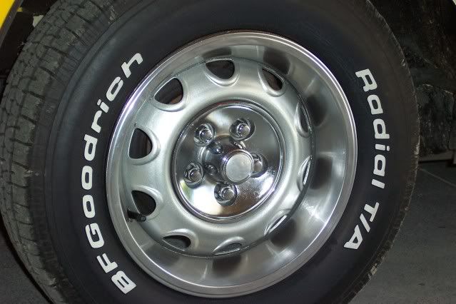

Rustyfords:
I pulled it off....and bent the tabs out a bit...and it stopped it.
The tabs on those wheelcovers get pushed in over time which makes for a loose hubcap.
I got plenty of loose stuff, marbles etc., but luckily nothing related to wheels, trim rings fit nice & tight.
The sound was valve train related, frequency of tic paralleled engine rpm, and only one rocker was complaining.
