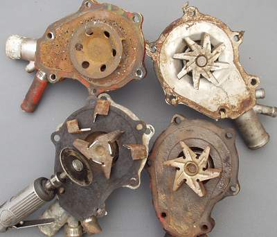

The last 8 blade waterpump I bought was made by GMB, Japan. GMB also makes a lot of "low cost" U-joints and other replacement parts. I think I bought this 8 blade impeller waterpump at Kragens.
Here is a pic showing some of the different SL6 waterpumps.
Check-out the one modified for high RPM use, this racer trick cuts every other blade out of the impeller, to reduce drag.
Wow, wouldn't that severely reduce the efficiency for not much power gain? Or is the gain more than I would think it is?
And what the hell is up with that round impeller up the top left???
