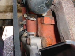

Look at the water pump by-pass hose. If it is short about an inch, its a 170.
If it is long, about 2-1/2 inches its a 225.
<img src="http://farm4.static.flickr.com/3173/2992308402_5481afb26e_t.jpg">

This is the pad where engine ID was stamped:
If the block has been milled, the numbers may not be there.
Here's the hose in question. This one is a 225.

THANK YOU VERY MUCH- your info was spot on. iwas looking at the side of that boss, not on top.(i didnt think there was enough room on top for any punchstamped numbers could be read). i,m a little disappointed now too, cause it,s a 170. oh well, i dont think the mrs,s is really going to know the difference any way. it,l still do plenty of wagging though! thanks again
